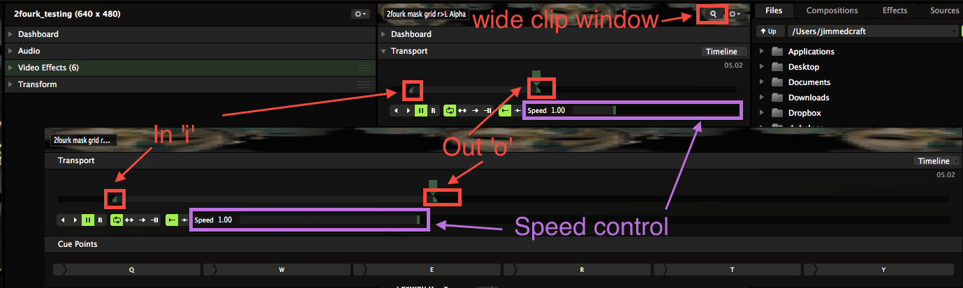

Use In and Out points (default short cut 'i' & 'o') and or Speed control. I personally find it best to press the wide clip window button and pause clip so you can can have precision. See attached image.covewi wrote:Is there an area where I can set the time for how long a clip will play?
