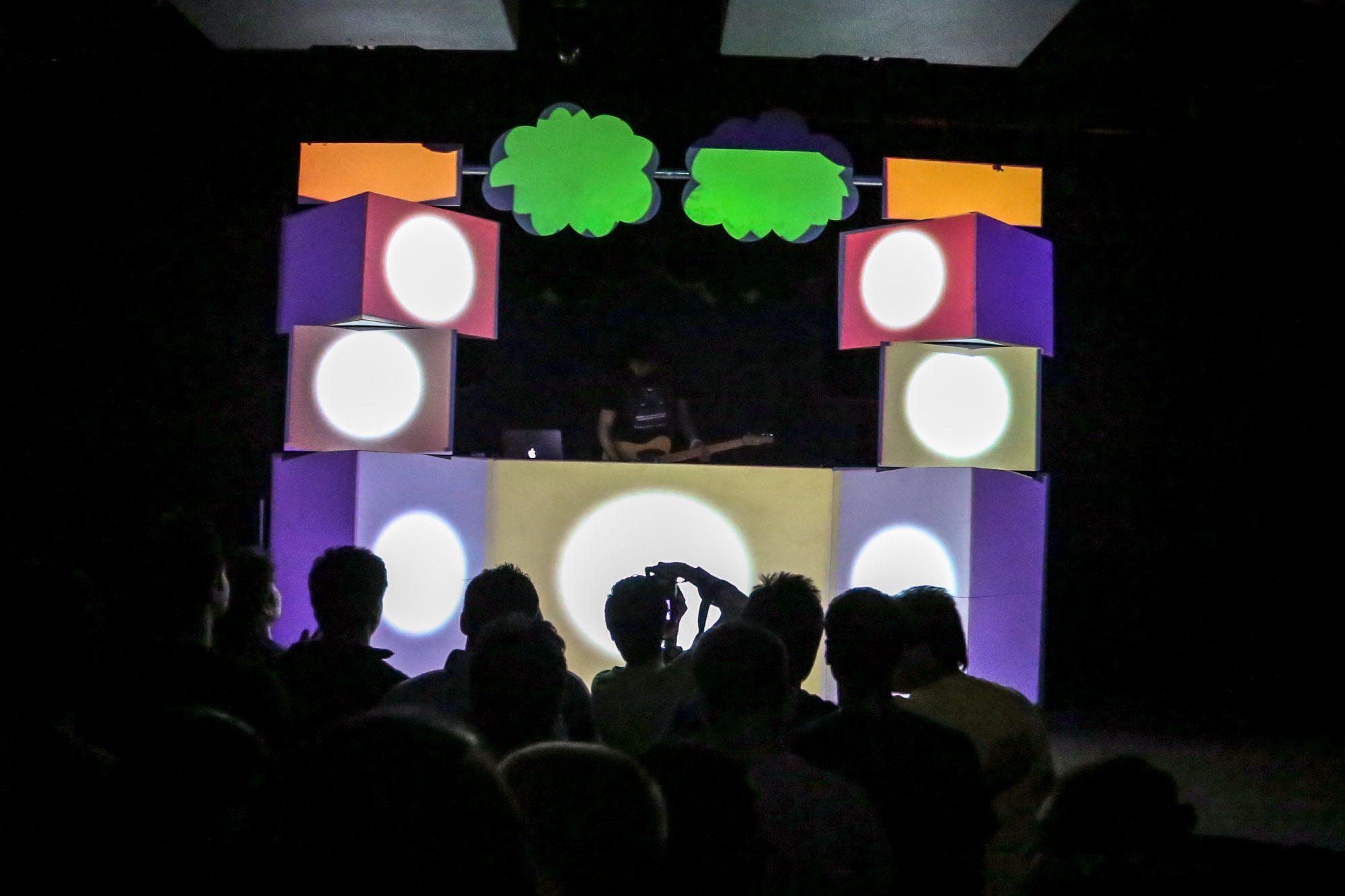

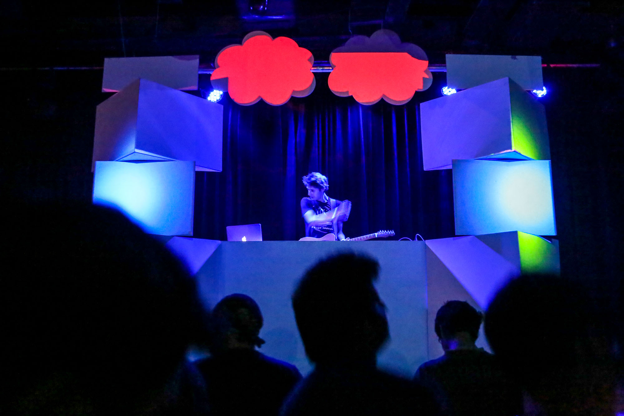

hi guys been using arean for overa year done some small projection mapping projects with this which really worked well . pics

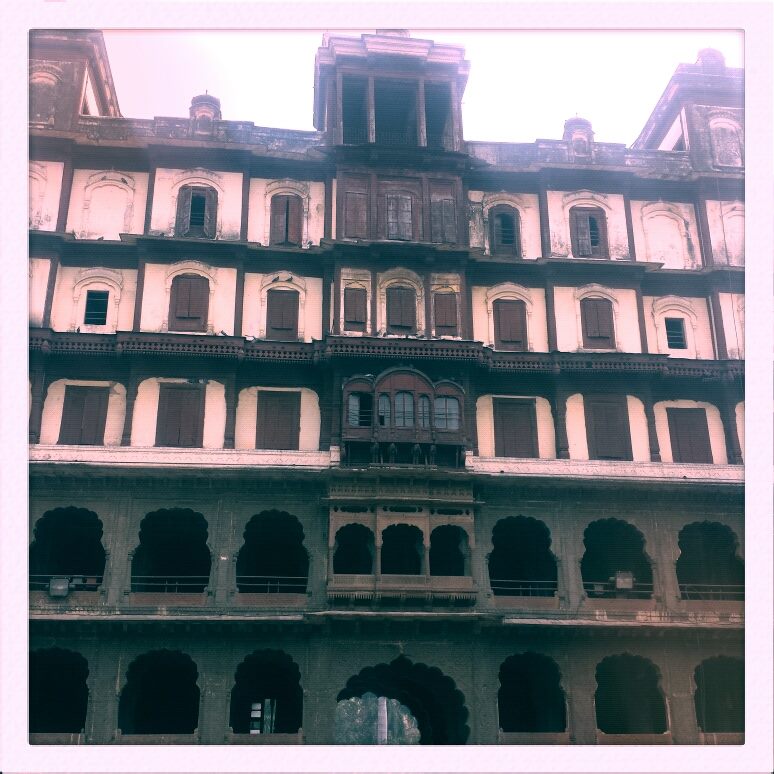

and now i have a chance of mapping this building for a fixed install sound , light and video show for a monument in india :
looking for ideas on how it would be best to produce content for this keeping in mind it needs to be mapped ..
the width of the building is 84 ft and the height that is gonna be used is about 45 ft

For what I can see in your other mapping project, this monument is too big for your level, and adding light to the project is another difficult thing.

I don't know what else you have worked on, but the fact the mapping those 2d clouds seems to have been a tad difficult for you makes this a mountain of a task.

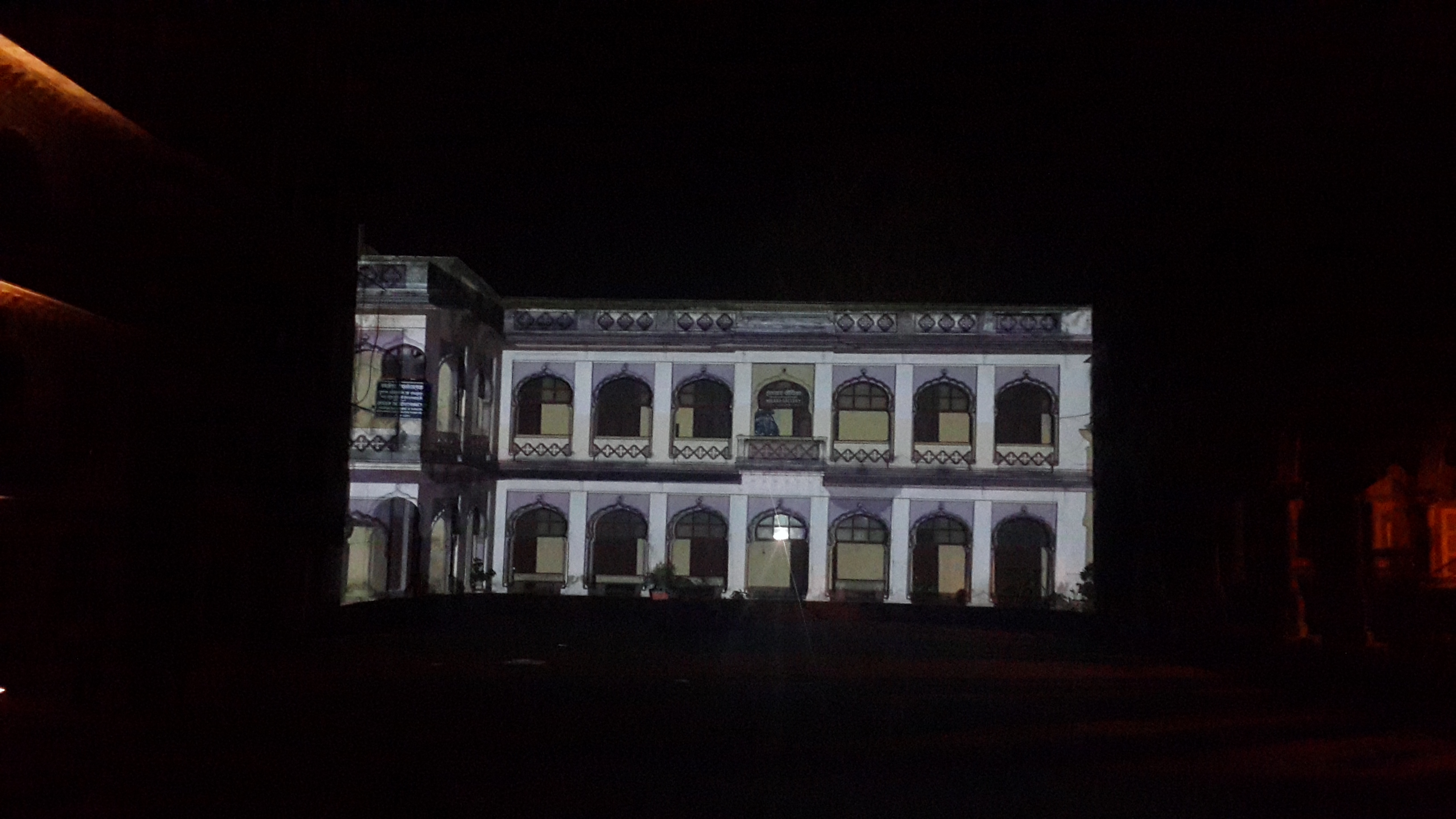

1st test of the 3d model !!!!!!
