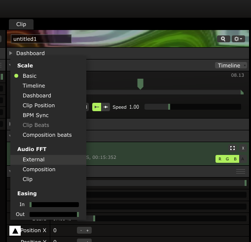

Maybe your Video is a bad example but :
for this u just need to put the external audio source to your wanted effect ( in your video the scale ?! )
if u dont know were to find this check attachment image
to combine the sound to the speed / transport of the clip is so far not possible i think...
Click on ( here Black on white) triangle next to the parameter you want to change, then chose source
extern audio.png (59.79 KiB) Viewed 12286 times
