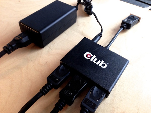

So when we heard that they make a dongle which can extend a single Displayport output to 3 Displayport outputs, we just had to order a few units for testing. We simply can’t resist a fancy new dongle.
Here’s the nitty gritty on this little gadget.
It’s not a simple splitter, the operating system will see each of the three monitors as an individual output and you can send each different content, or one big video stretched over the 3 displays. That’s 3 times 1920x1200, son!

After a quick unboxing session, we found out that although the device looks very neat on the website, it comes with a big old power block which is nearly twice as big as the device itself. You can say things like that shouldn’t matter in a review, but it’s good to know about when you need to pack for aircraft regulation limits or stuff things into a backpack.

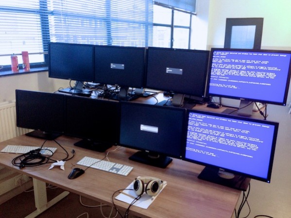

Of course we had to push the limits, and also connect the two remaining miniDP ports as well as the DVI output. The desk looked fancy sporting 9 monitors, but all we got was a lot of blue screen of death. So even though two MST hubs works flawlessly, using them in combo with a third display on the card was a no go. We're still not sure what exactly caused this, but there was no way around it.
