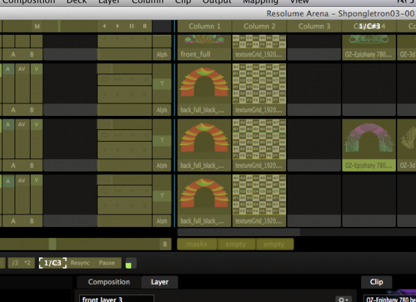

I save my composition with MIDI mapping on just one column trigger and tap tempo trigger, so the DJ could control those. Two shows in a row by now, either one or the other thing shows up not mapped.
I re-map it with the DJ, save the file, yet the next show - same thing, one or the other trigger are not there and we have to re-map.
I am using MIDI Jet Pro for wireless MIDI transmission.
Magic MT4 to send MIDI to me from the DJ.
Arena 4.1.6
By my logic, the hardware shouldn't matter though, the mapping should stick and re-appear just as I saved it, regardless of stuff being plugged in or not?

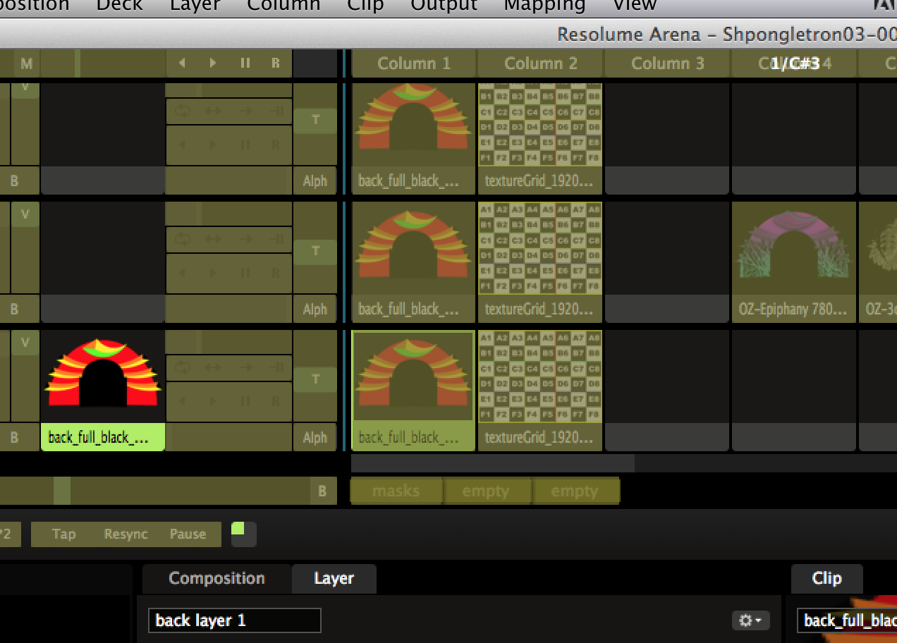

Surely enough the mapping on one of the buttons disappeared again (see screen shot).
I definitely saved it after it was mapped (as the image from my previous post looked like).
I am attaching both my compositions (the one that opened with mapping missing, and same one after I saved it re-mapped in the posts below).

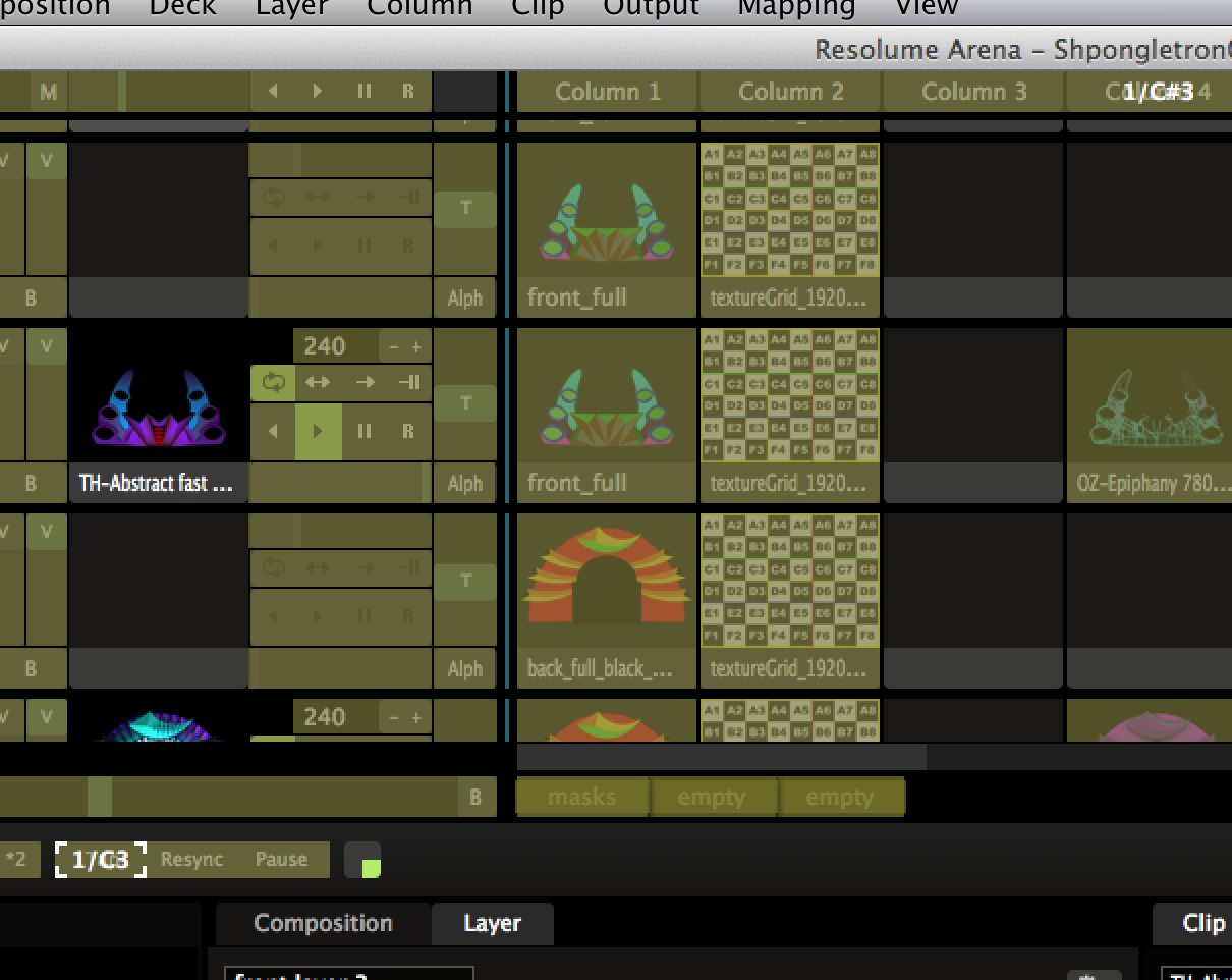

Attaching the composition with mapping missing. About to re-map. Will attach re-mapped composition after.

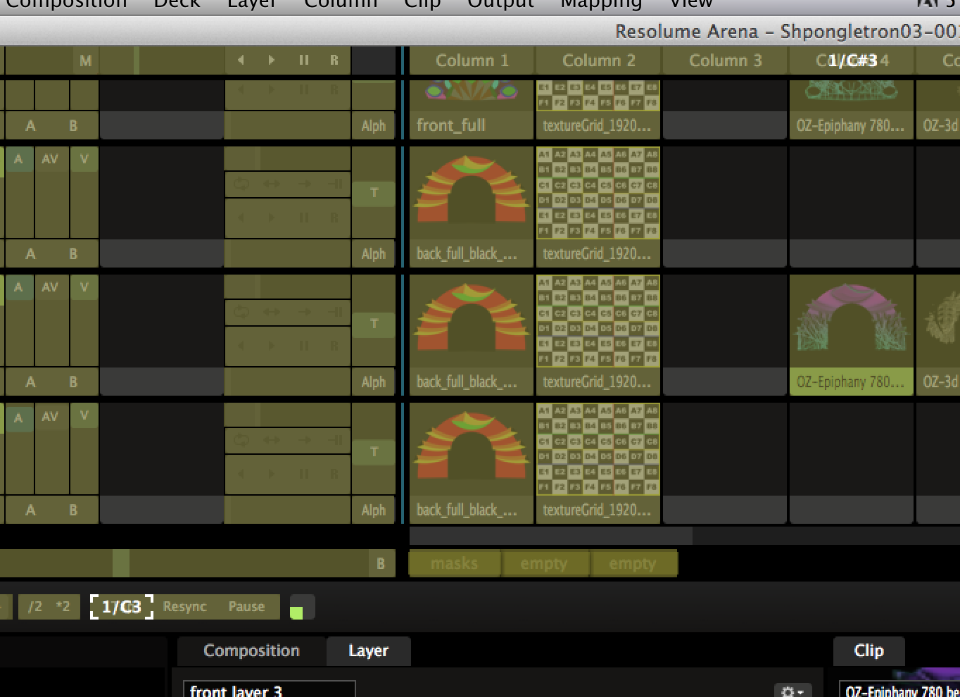

Here's the composition (just saved) where both buttons are MIDI mapped properly (attaching a screen shot and the composition):

Thanks for the files, Zebbler.
It looks like that aside from the BPM itself, none of the midi shortcuts for the BPM tap/resync buttons are saved in Comp Midi Map.
I'll make a ticket for this.
Just out of curiosity, why do you use Comp Midi Map for this ( as opposed to loading a different App Midi Map via the preferences) ?
