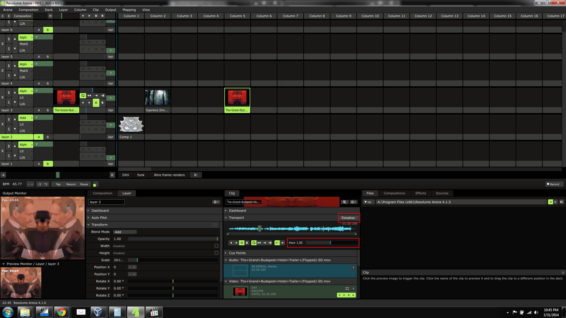

Wait, i think I misunderstood what you are asking. If you simply want to make the clip faster, just change from BPM to timeline, as shown in the first picture below.

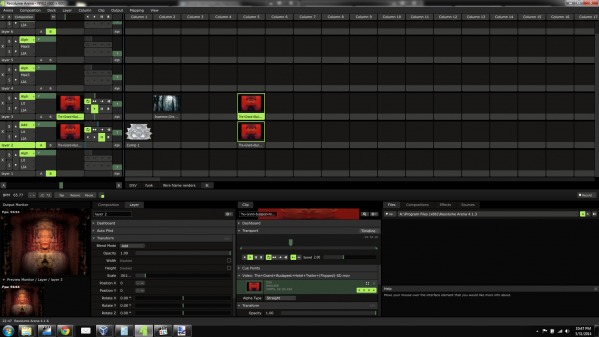

If you can handle multiple layers, copy your video to each layer, on the top layer, click the x under the audio tab for the clip. Then double the speed for the video layer. If you trigger both clips by column you now have an audio clip at regular speed and a video clip at twice the speed.
