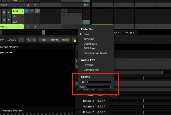

Hi Conduit,
maybe the easing parameters which you can define for mostly every parameter will nearly fulfil your needs? ;)
Enjoy!

Post by Conduit »
They don't hurt, but they're no match for a greater degree of control. You could, for example, automate the x/y positioning of a clip, ensuring that the repositioned clip always stayed centered over a certain part of a moving image from another clip in the column... Doesn't matter where the certain part is as long as the parameters are automated properly and both clips are synced.
