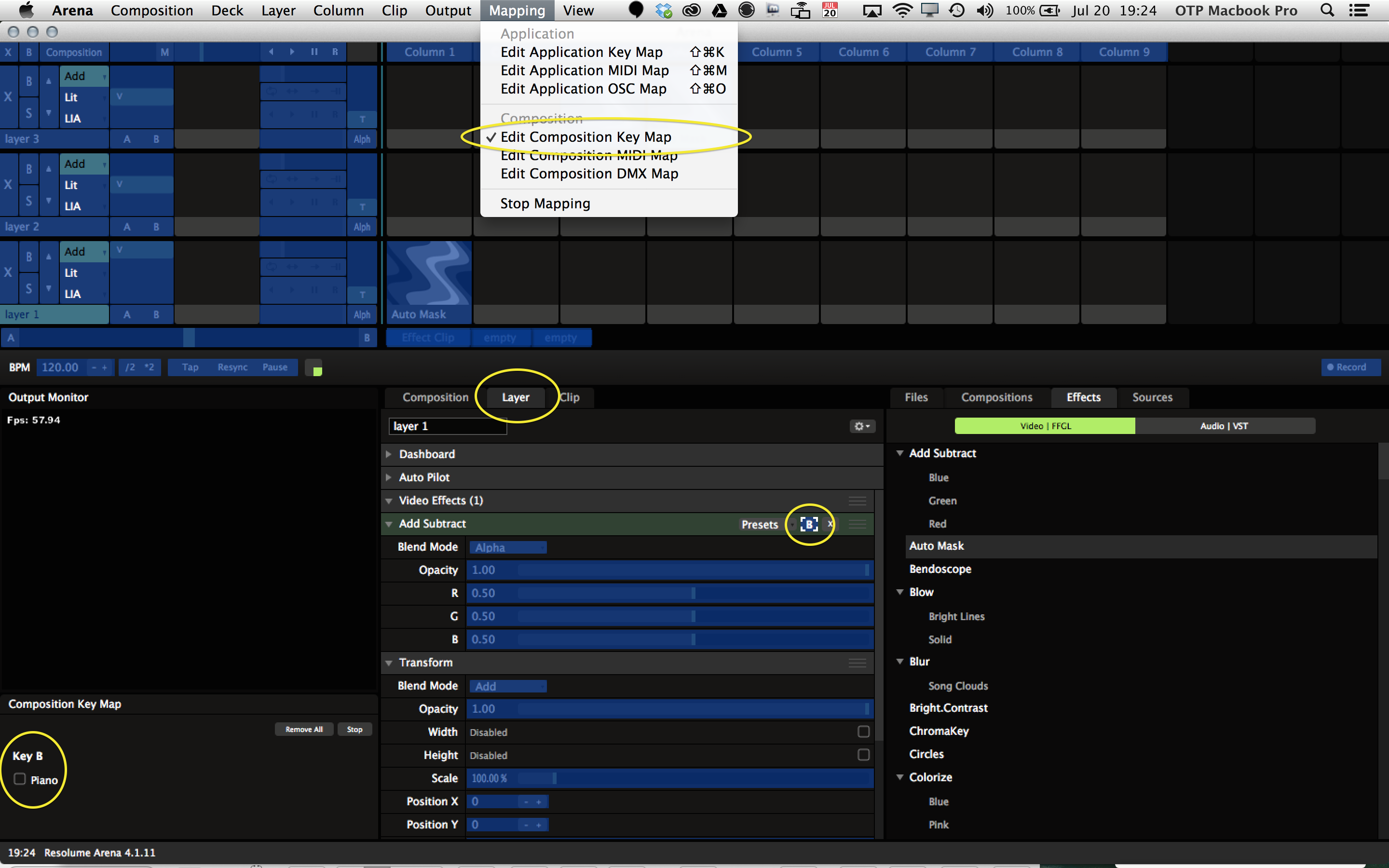

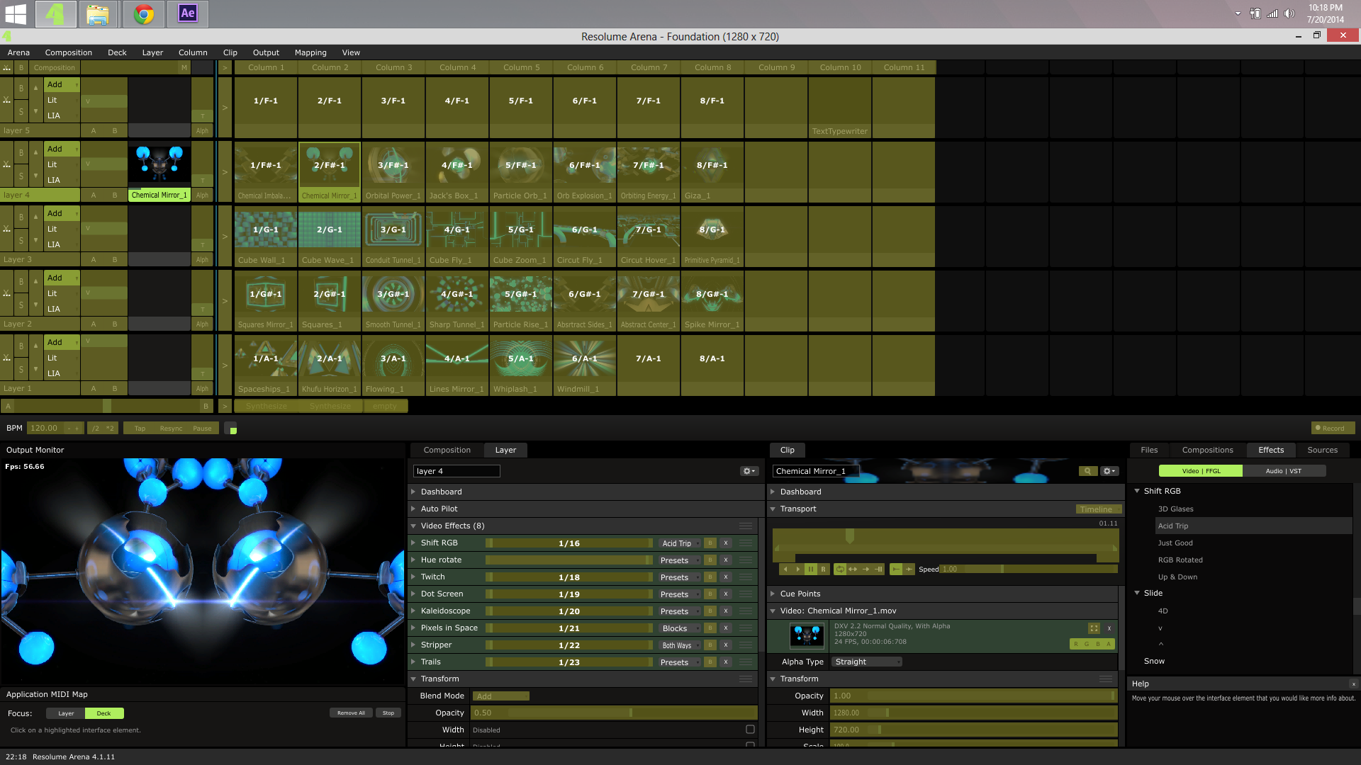

Assuming your effects are in the layers/composition not the clips, one trick would be to use either application or composition key mapping and assign keys to the effects' (blind) mode . Note that you can assign the same key to multiple effects so that you could group them in layers. You could also do it for effects in clips but that could become a lengthy process and you might run out of keys!
Here is a picture to show you the layout:
That way, when you hit that keystroke, all effects that are in one layer would go to blind.
Note that you could use DMX, OSC or MIDI mapping as well but Key mapping will be quick and easy to test.

Thanks for the screenshot! I couldn't get that to work i'm using an APC 40. You can see by my screen shot i have all effects in that layer and duplicated them in each layer except for the top where artist logo's go. Instead of all those effects in each layer i'd like to put it in the composition and assign a layer to mute effects. I'm sure it would help my lag problem too! Its probably not possible maybe next update!
