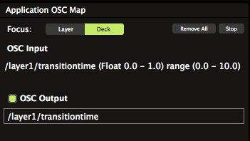

I'd like to drive the transition time via OSC, but I can't find it. Is there maybe a list of addresses that are not displayed when you click on them in OSC mapping mode?

/activelayer/transitiontime (Float 0.0 - 1.0) range (0.0 - 10.0)
you have to select the layer first.
Re: What's the OSC address for layer transition time?
Or you can try:
/layerX/transitiontime (Float 0.0 - 1.0) range (0.0 - 10.0)
where X is the number of your layer and you can control all your layers at once.

Apparently I had scrolled upwards in my layered composition and didn't see layer 1 being lit green in the OSC mapping mode, and clicking the other sliders doesn't show you anything. :oops:

It sounds like you were in Layer focus. It might be helpful to read up on Layer and Deck focus, it is an integral part of using Resolume with any external protocol like OSC or Midi.
