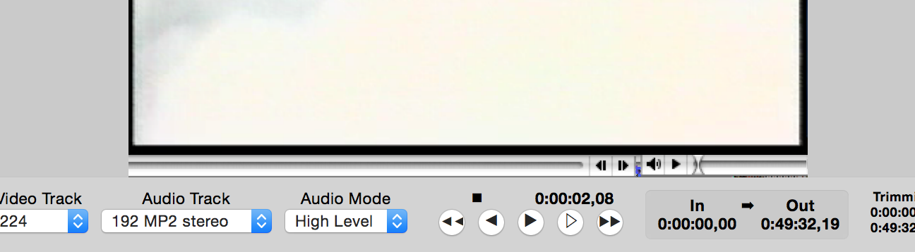

Hi there
I'm also having issues with mpeg streamclip Version 1.9.3b8 (1.9.3b8) on my new mac,
My new macbook came with Yosemite and now when I open mpeg stream clip the playback is distorted.
The screen is split in half and the playback bar at the bottom of the video is cut in half. I've tried changing the aspect ratio, which doesn't work.
My other mac has mavericks installed and it works fine, it just seems to be on Yosemite that the issue occurs
I've also tried installing an older version of mpeg, which doesn't help either
Has anyone else experienced this? Is there any work around ?
I tried installing QTAmateur but it won't load any clips I try to open.
Any help would be wonderful

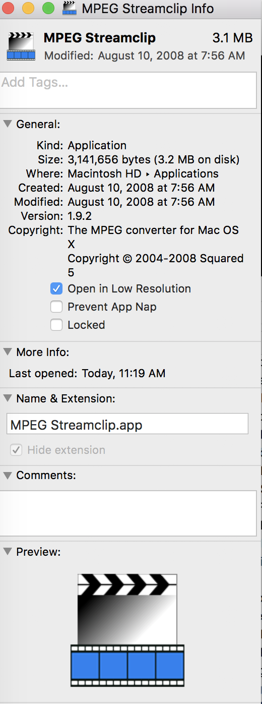

Re: mpeg streamclip problems
I know this is a very old post, but I thought I share the solution.
Close the MPEG Streamclip application.
Select the application in Finder and press command+I to bring up the 'MPEG Streamclip' info.
Check the 'Open in Low Resolution' checkbox. Relaunch the application.
Problem fixed!
Problem fixed!
