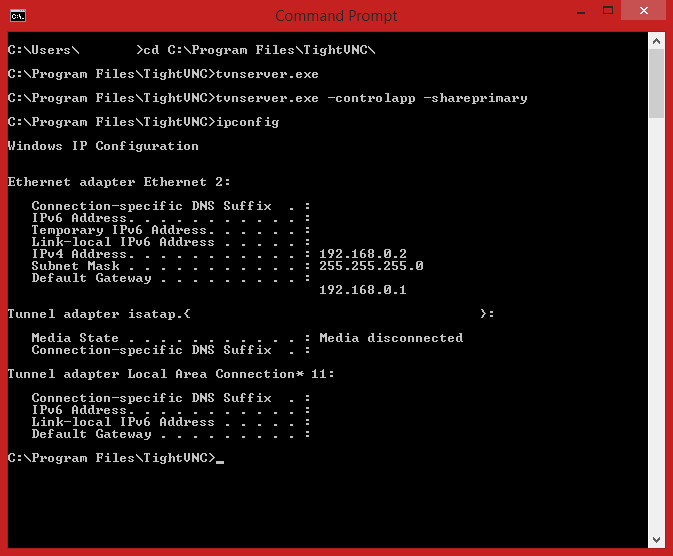

To do this (Windows 8 server side)
A. Open the cmd prompt
Windows 8- Push the windows button (to get to the metro interface) then just type in "cmd". The search bar will pop up on the right side, select Command Prompt.
Windows 7- Open the start menu, type "cmd" in the search box, select Command Prompt.
B. Copy these 3 separate lines of text and right click in the command prompt to paste, pushing enter after each
Code: Select all
cd C:\Program Files\TightVNC\
then
Code: Select all
tvnserver.exe
Code: Select all
tvnserver.exe -controlapp -shareprimary
Note 5: If you forgot to uncheck "install as service" just the previous code to
Code: Select all
tvnserver.exe -controlservice -shareprimary
5. If this is your first time running vnc server, its a good idea to add a password so no one else will be able to jack your show. In the icons area of your screen, click the V icon. Click the Set button under Primary Password. This step is optional, but recommended.
6. Now you need to find the IP of the server so that the viewer/remote computer can connect to it over the network. This will be a string of numbers, and if you aren't familiar with networking jargon it can look completely meaningless.
~3 ways to find this
Easy Way-Scroll over the V icon again without clicking. It should show a string of numbers like 192.168.0.2.
Medium Way-Go to your control panel and find it, search google for exact directions.
Hard Way-Go back to your command window and type
Code: Select all
ipconfig
