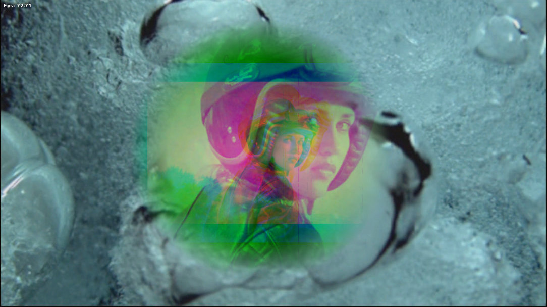

If you want something like this:
Create in a top layer at 100% Add, in a clipchoose a Solid Color as a source (Green for instance), render it square (render width = render height = the largest dimension of your comp), add a Vignette effect, select the roundness etc..., select Black BG in the vignette, add a Chroma Key effect and and cancel the green from your Solid Color. Now you should be able to see everything in your bottom layers through the round hole.

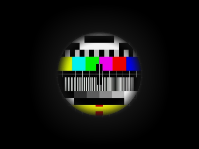

look at the attached image,
I want to do the same just circle and not ellipse without stretching the image
