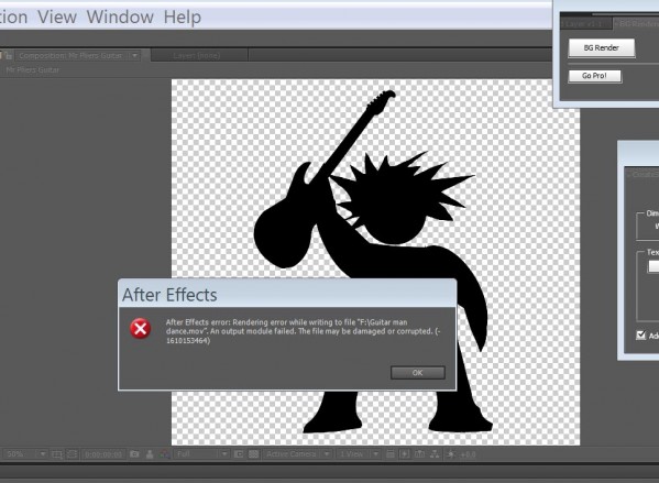

Hi - I`ve just installed Arena 4.21 and thus DXV 3 and I`m now getting that same error message where I wasn`t before in After Effects. It just won`t render anything. Any ideas, I don`t really want to go back now to 2.2 ....... cheers John
