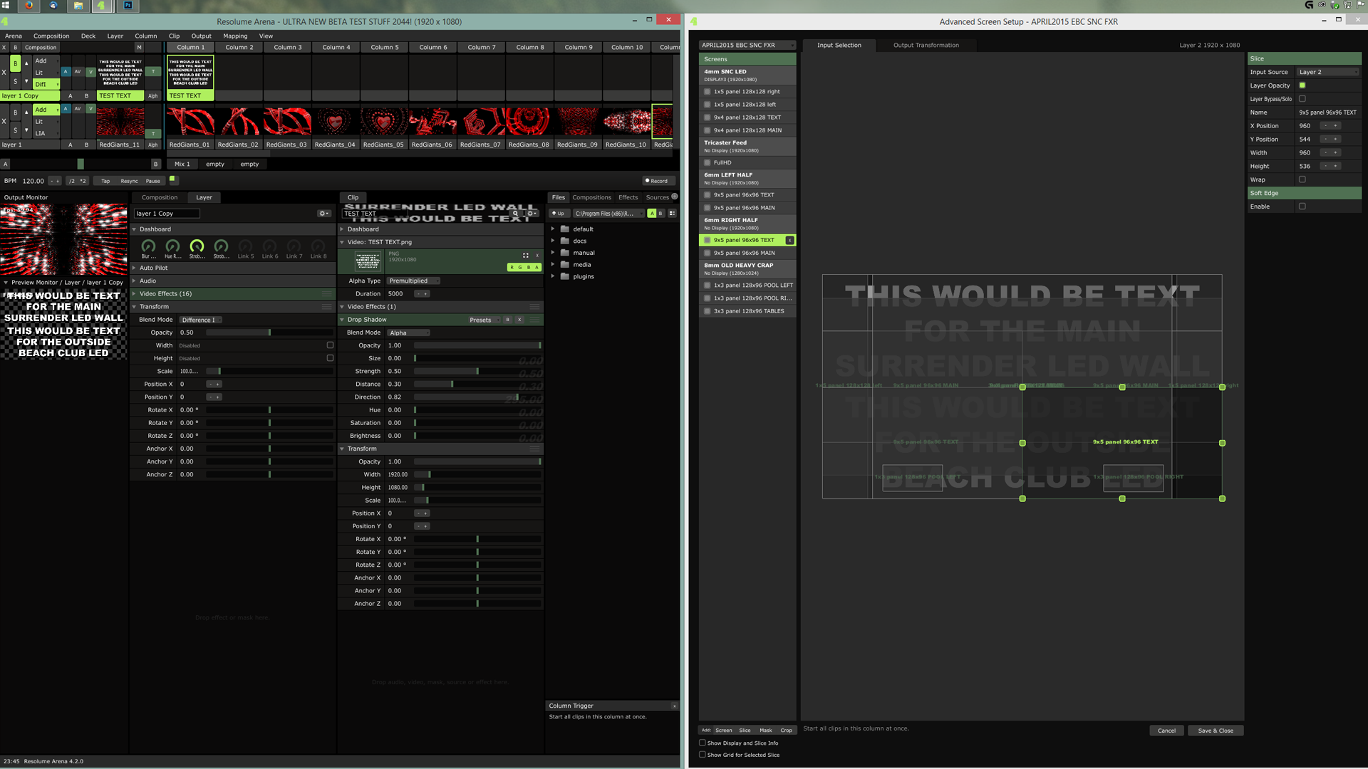

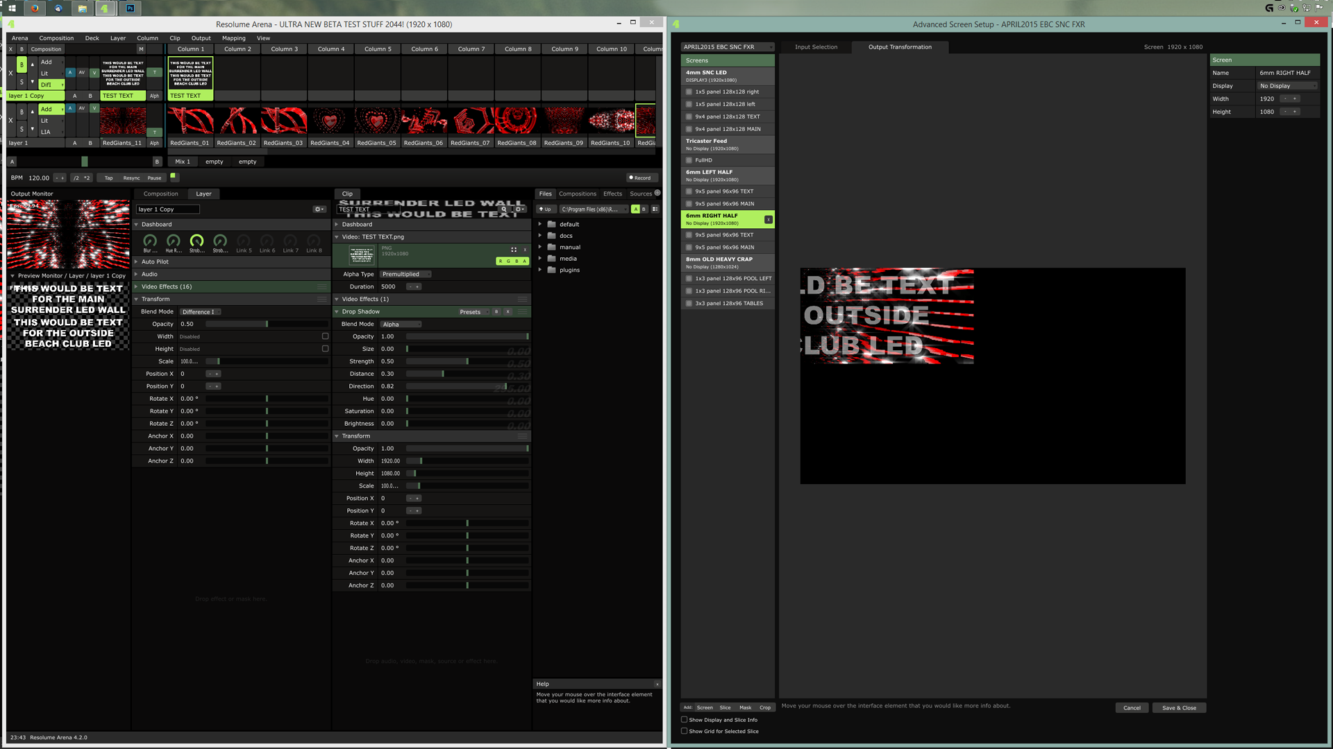

When using the fancy new layer bypass with layer routing, blend modes don't work for slices under what's being routed.
Could we get slices to work with blend modes when using the layer bypass fade option?

It's very unlikely this will happen.
Resolume has a distinct compositing stage. All blending and mixing of layers happens in the composition. The GUI is designed to make this easy and intuitive. The resulting texture of the compositing stage is then passed to the advanced output for distribution to different screens and output.
When using layer to slice routing, you actively choose to bypass the compositing stage, so any blends and composition effects are ignored. It's best used if you quickly need to make a simple setup or as a last resort for a complex mapping that cannot be handled otherwise. It's the pixel equivalent of painting yourself in a corner, because you lose a lot compositing and other functionality when using layer to slice routing.
Because it's so easy to reposition and duplicate content in the advanced output as opposed to doing it on the layer, people have started using layer to slice routing just to position layers. So we're looking into if we can offer the same intuitive distribution options on the layer, so you can easily create your setups in the comp, keeping all your blend and effect options.
Added advantage would be that this would also make it easier to use multiple output setups and change them live.

I have 2 different LED screens that I need to send messages to.
With the 4.2 update and bypass trick, it has made my crazy layer router setup a lot easier to manage (so many special scenarios). I went from 13 layers to 9.
I used to have 2 separate layers for text stuff, now I use the top half of my flash text for one screen, bottom half for the other and just route it to the center of the screens. I actually have 5 screens I send content too, but text and messages are only for 2 of them. The "half" screens in the images are actually 1 big screen @ 1728 x 480, my other is 1152x512
