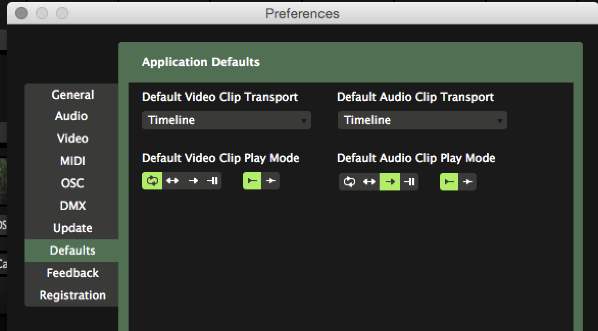

Have you checked your default settings on your hackintosh? Audio and Video files have different defaults clip transport modes so that could be the culprit.

yes, I checked it as well. and as I wrote if I delete the audio channel that is fix the problem. only clips with embedded audio or audio files brings up the problem.
4.1.11 doesn't produce the problem and all res versions shares it's prefs so if I have something wrong in 4.2 it should be comes up in 4.1.11.
