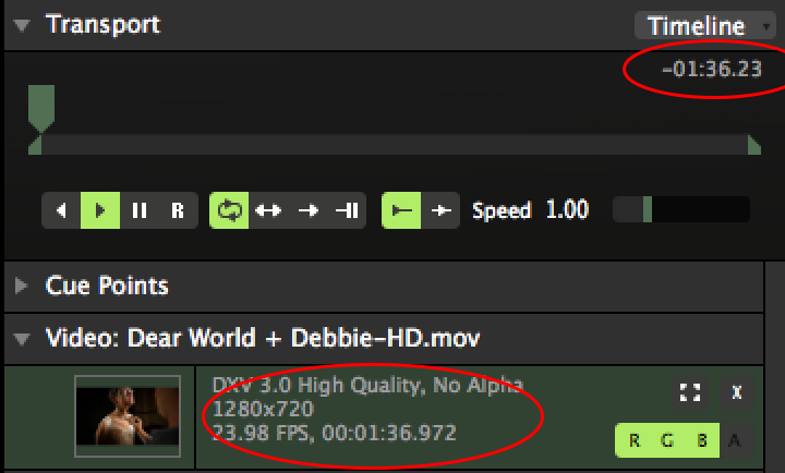

Add a DXV3 High quality clip with no audio:
The total time in the timeline differs from the actual clip info.

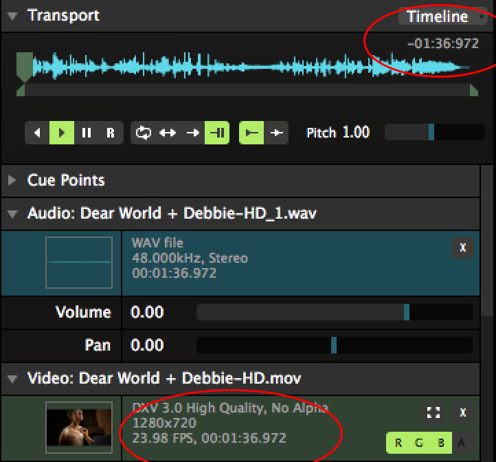

When the matching audio is added (WAV file)
the time corrects.

As I found out myself in viewtopic.php?f=12&t=11305&hilit=timeline+joris#p45415 when a clip has no audio, the time is shown in FPS (HH:MM:SS:MS) rather than milliseconds (HH:MM:SS:MS) and it doesn't show the decimals which means 1:36:972 in MS is equal to 1:36 + 972*23.98/1000=23.30856 FPS or 1:36.23 when you rounddown.

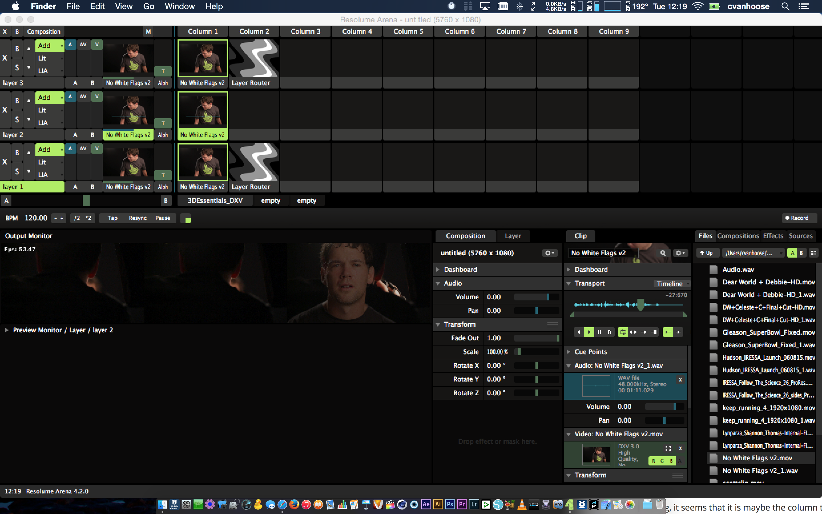

Upon further testing, it seems that it is maybe the column trigger not triggering them in sync.
I am IN show right now and did a quick test on my MBP retina. Similar setup to the show on a small scale.
I have no transitions timing set for this test: (The show has timings, wish I could input a specific transition time)
Column triggered results in an out of sync video over a couple loops. Maybe its a load order?

The screenshot I posted above is showing 1 clip with the audio and 1 clip without the audio ----->SYNCED,
but one of the clips without the audio is losing its loop.
Here is the screenshot below:
Layer3= -1920 on the comp...far left
Layer2= 0 on the comp...center (this layer has the audio linked)
Layer1= 1920 on the comp...far right
