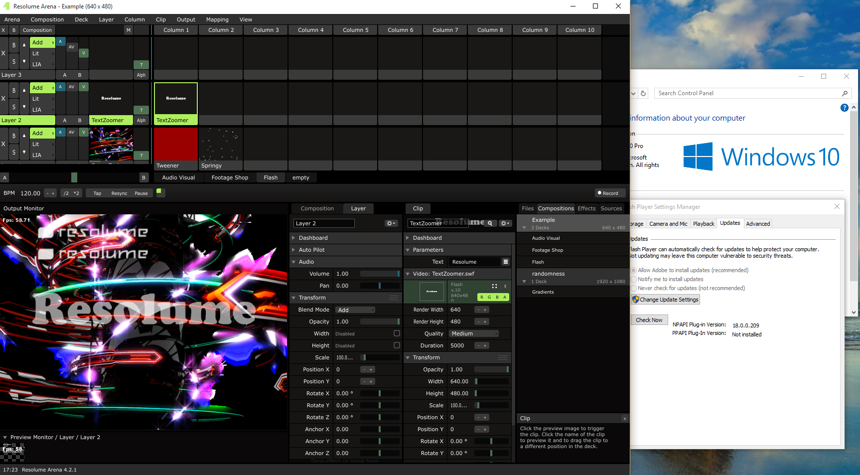

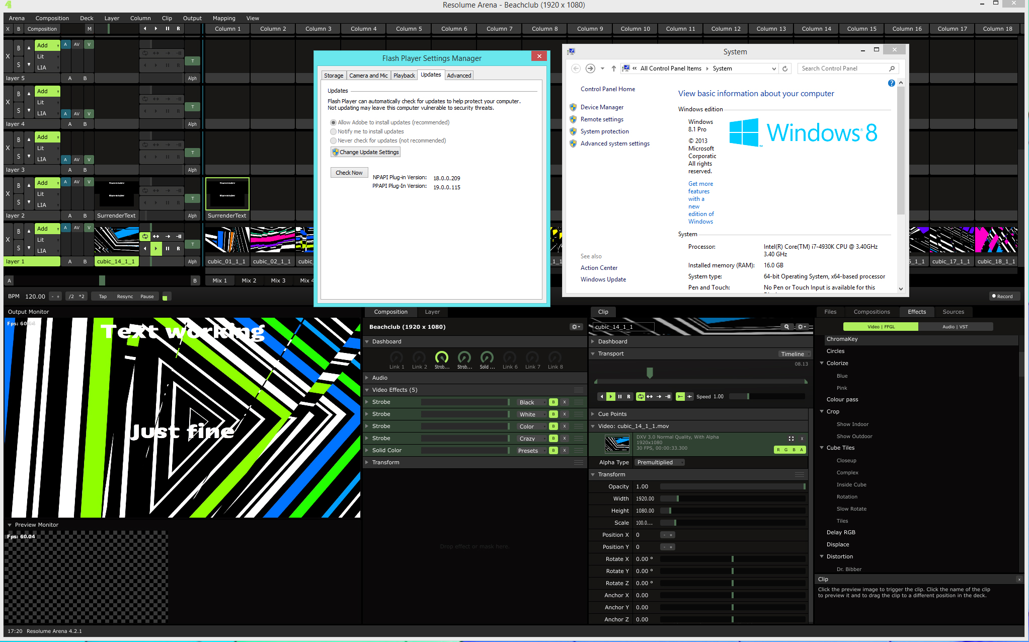

I've test my own Flash text files on Windows 8.1 test server, as well as a Windows 10 laptop, both with latest Flash update and everything works fine. All Arena 4.2.1 and 4.2.0
Edit: attached images from both systems. 1 with Resolume supplied Flash and other with my own Flash
