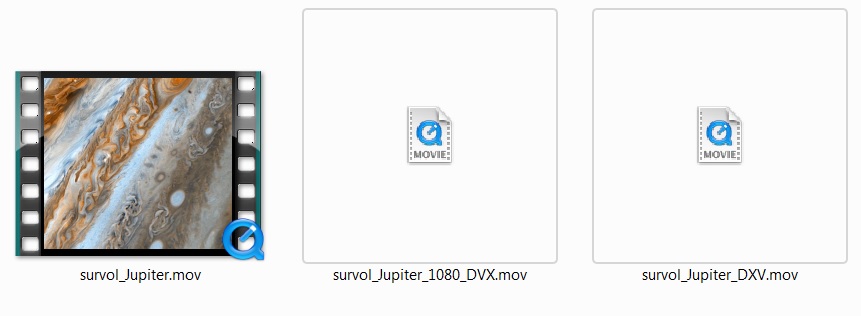

Btw, ist there a way to make the Thumbnail also visible with DXV-clips like in the H264 ?
Left: Thumbnail visible in H264; Right in DXV not

Are you on Windows? If so, Windows Explorer and Media Player cannot extract thumbnails from DXV clips unfortunately - you will need something like Adobe Bridge or possibly some other media browser that can cope with DXV files.

craftycurate wrote:Are you on Windows? If so, Windows Explorer and Media Player cannot extract thumbnails from DXV clips unfortunately - you will need something like Adobe Bridge or possibly some other media browser that can cope with DXV files.
Oooooh! Yes, I am on Windows. Unfortenaly Adobe Bridge is not a freeware, even quite expensive now!

He2neg
Posts: 947
Location: Berlin, Germany
Re: R4 won't play clips!
Post by He2neg »
Xn View is a good Solution for organise your libary... you can preview dxv and move it around as well..
