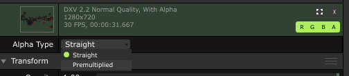

After loading into Resolume, try changing the alpha type setting and see if this fixes it.
alpha settings.PNG (10.94 KiB) Viewed 35961 times

As t13swift mentioned, DXV files should be played in [Straight] Alpha Type.

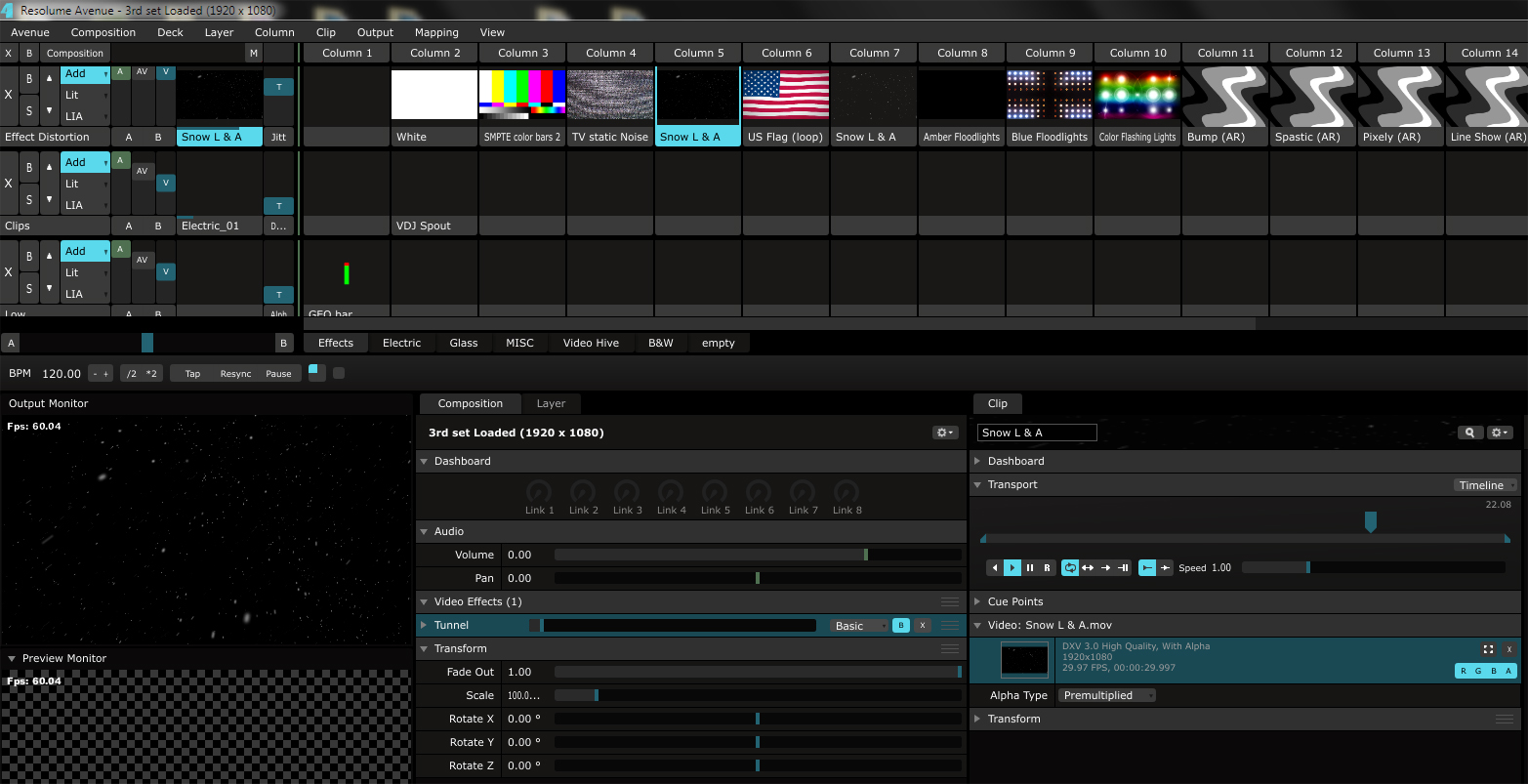

Hi Guys, completely new to Resolume and just learning. However I am pretty good with Adobe and video editing. I am having a similar issue when I was re encoding all my files to DXV 3. All went great except one .mov file with Alpha that shows as being PNG in Resolume.
That original PNG clip plays with Alpha support like it is supposed to but the frame rate drops to about 15! When I re encode it to DXV 3 using Normal or High quality with Alpha, on playback in Resolume I still get the black background. I have checked the settings several times and tried with Adobe Media Encoder and Premiere. I basically lose Alpha when I re encode.
After reading the above "Straight" suggestion and I also tried the A button on the Resolume clip settings, but it does not toggle the Alpha on or off. I just always get the Black part. I am sure it is something I am doing, but no idea what. You can see on my attached screen shot that the main output there should be a clip shown below the snow...

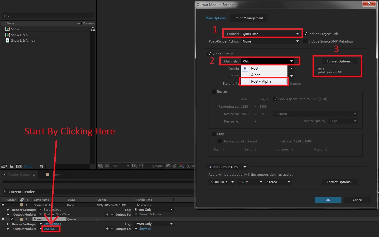

Thanks! Actually I just re encoded the clip with AE and remembered the RGB + Alpha setting there (which was different in Adobe Media Encoder and Premiere). Re ran it and problem solved!
Thank you!

Just in case others are wondering what I did in Adobe After Effects (that was not in others), see my Render Cue settings below
