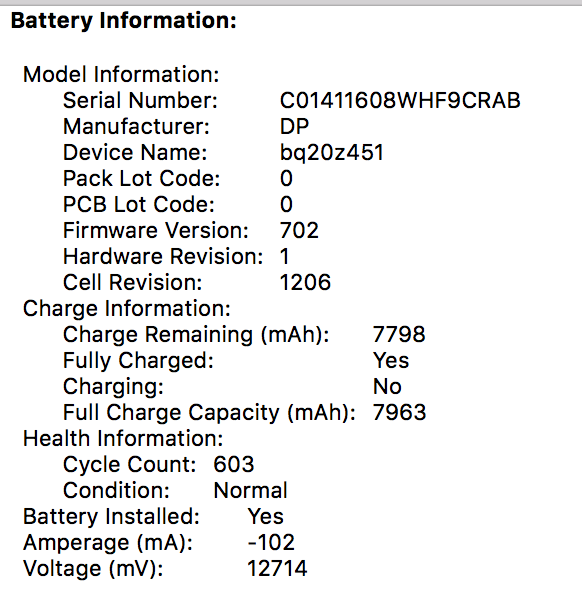

It could also be that your battery is bad so check out the condition of your battery in System Information>Hardware>Power. Here is what mine looks like:
