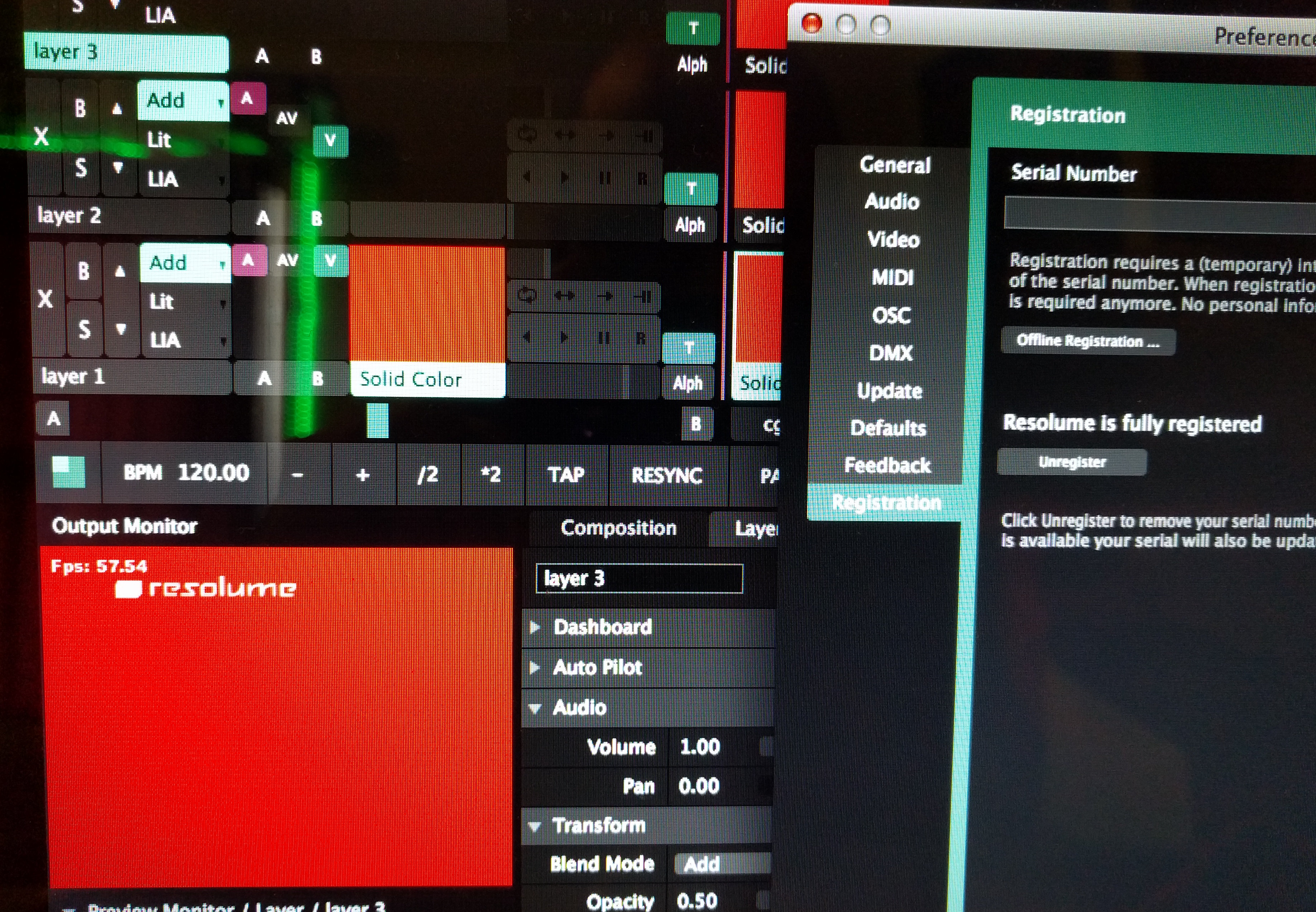

Has anyone else had Arena 5 start behaving like it's unregistered, at random, in the middle of a set? Everything starts out fine, but at some point I start seeing the watermark / hearing the robot voice. Preferences pane still shows my software as registered (see attached photo).
If I quit and restart, the watermark goes away - until the next time it happens. I'm sending a ton of MIDI data in via an external step sequencer when this occurs, if that has any relevance. Luckily this has only happened in my studio so far, but it's making me nervous, as you might imagine.

UPDATE: 10 minutes after posting above, my registration got bounced again. I had just finished installing Ableton Live 9 Lite to test more sequencing ideas, and routed MIDI from Ableton to Resolume, again through IAC Driver Bus 1. Not sure of the exact moment when the registration failed, but this time when I looked in the preferences, it showed as unregistered.
Trying to enter my serial number, I get the error message "Unable to contact registration server, please contact mail@resolume.com". After closing and reopening Arena, it once again shows as fully registered.
