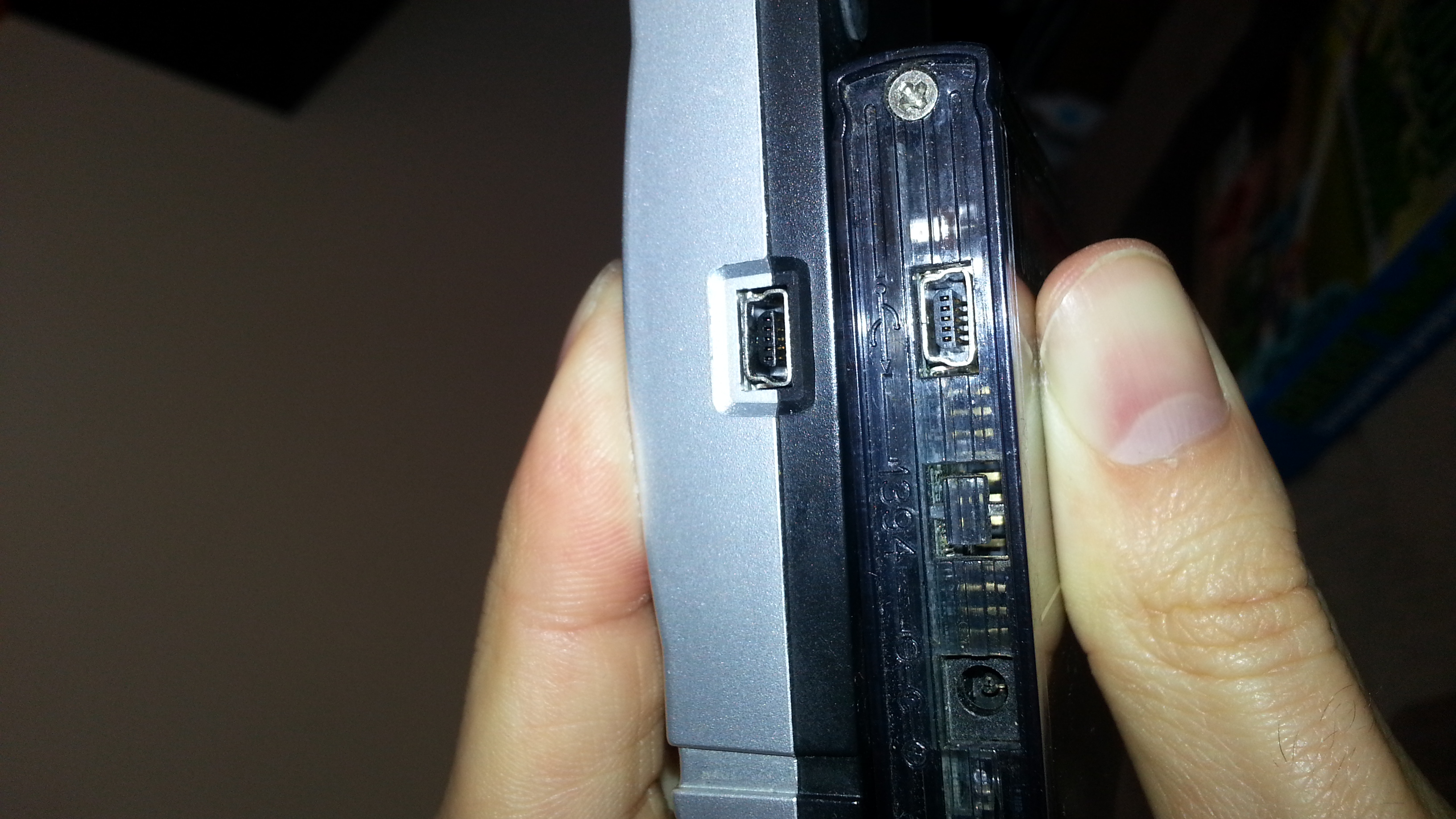

Um, I think someone has broken my controller's USB port when I left it in a venue for 2 days and has attempted to fix it, poorly.
You're right, on one other PC it also fails to be recognized and on another one it flip flops between being found and name properly displayed but not responding in Resolume and not being recognized at all.
I checked the pcb and I'm not electrical engineer but I doubt AKAI does such a poor soldering job:
Can anyone spot anything wrong or damaged?

pin2 seems to be bent, or broken.
that would be the data- pin,if I'm not mistaken.

That would explain why it gets powered but doesnt function properly.
Although, do you have any device with a mini-USB port you could check? I only have one external HDD and the same pin seems bend, dunno maybe its how it is supposed to be.
If not I could get the port desoldered and a new one soldered on its place.

Re: AKAI MPK Mini not recognized by Windows
this is a usb drive and my card reader,
do you use your devices with the same cable? maybe the cable bends the pin.

I see. This definitely needs the port replaced, and it clearly has been already. I see poor solder job and flux leftover.
BTW, its odd but your ports seem a bit different than what are on my devices. The pins are surrounded by plastic on all sides while on mine one side is open.
