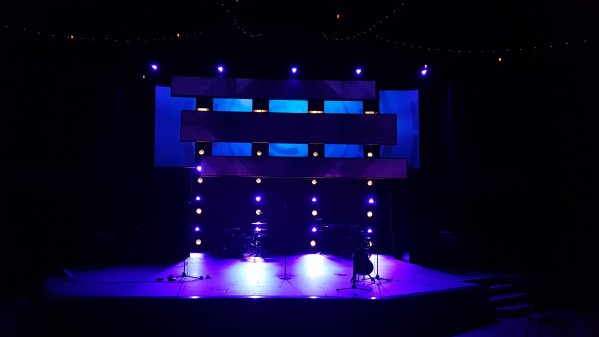

So, this project probably isn't super interesting for you veterans, but this is the most complex mapping thing I've ever done. Only been doing mapping with Arena for about 2 years maybe, so I'm still decently new. Anyways, onto the project. I'd love you're guys' input on what I can do to make my composition/output better. So, here's the design:
This is being projected on with a single 16K projector. In addition to this, we also have two 8K projectors as side screens. The center screen design is a two layer thing. So the 5 panels in the back are sitting roughly 6 inches behind the 3 horizontal bands. The way I've mapped it so far works fairly well. I'm limited a little bit with what I can do, but not a ton. Only issue is, it uses a ton of layers and layer routers. I've got 20 layers going so far and to add more functionality and options, I could easily double that if I keep going the way I am now. Also, right now I don't have control over the side screens. I'm just doing the center screen.

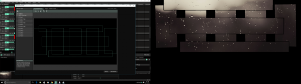

Here's a screenshot of the advanced output screen and the actual output:
I hope that all makes sense. I'm thinking there's a significantly better way to do this. Maybe using more slices in the output settings. The trickiest thing about all this is retaining the ability to use blend modes and composite video layers together. If I didn't need that, 9 layers would cover everything.
I'm wondering if it's better that I've kept the composition 1920x1080 and used the layer to slice method, instead of making a larger composition and spreading things around while having more slices that are set to take the composition. Basically just creating spaces on the "artboard" for each section I need.
Who knows. I've got a decent system right now, but I'd love to hear how you guys would map it. I've also attached my composition should you like to view the madness. You can download the screensetup xml file here: bit(dot)ly(slash)ScreenSetupFile

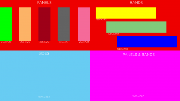

Re: Interesting Mapping Project
Here is how I would layout my composition (of course sizes are arbitrary):
This is based on a 2x2 1920x1080 comp which is 3840x2160 (4K).
I would create both Photoshop and After Effects documents with masked layers if you want different media for each panel/band. That way you can quickly render media (stills and video) to match this artboard.
This should let you do everything you're describing with 3-6 layers and let you manage the negative space (red in the png file) in your composition.
