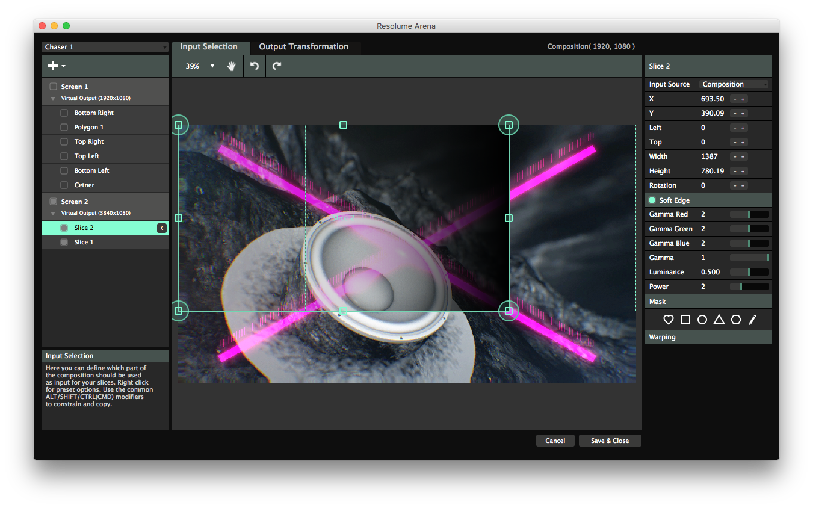

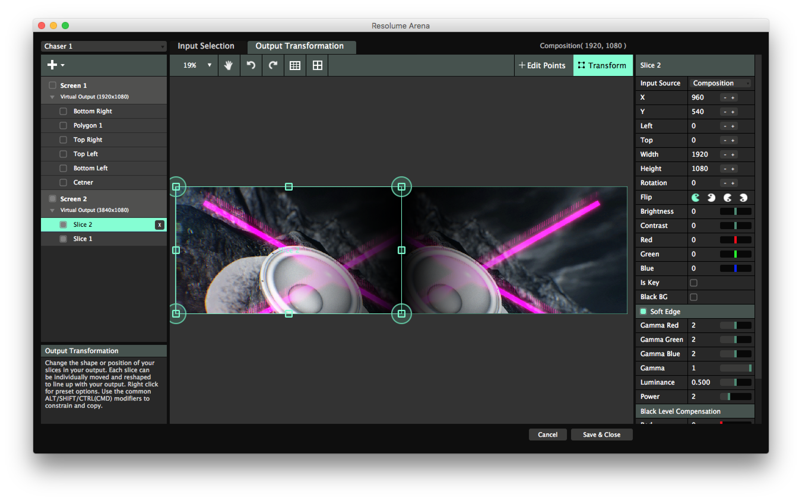

Resolume blends the overlapping areas in your input map (Input Selection) so having multiple slices in one screen won't make a difference but you need to make sure the slices don't over overlap in your output map (Output Transformation). So, if you have two 1920x1080 projectors connected to your TH2G, it would look something like this:
Input Selection: Output Transformation:
