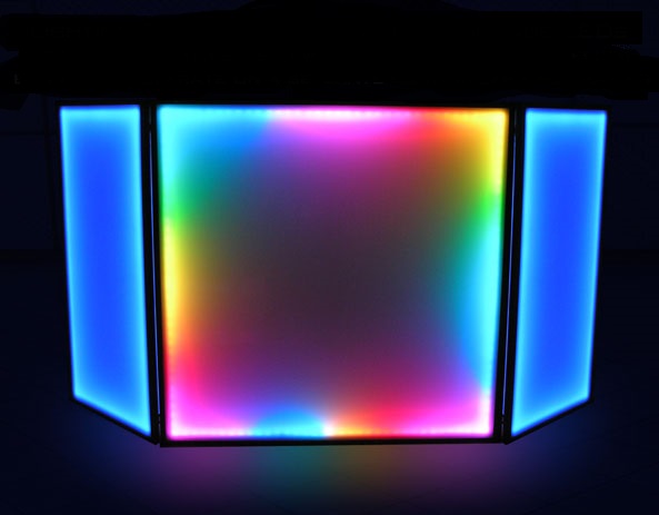

Hello,
I really need some help here and guidance on where to start with controlling LED strips through Resolume arena 5. I am seeing this being accomplished with either a Arduino uno, or raspberry pi. (or whatever else can accomplish this task effectively and inexpensively)
I am a complete beginner on this subject BTW, and while I see this being done on elsewhere on YouTube I have not stumbled across any good in depth tutorials on where to start that aren't completely overwhelming, and or over complicated.
I am seeing this article and it appears that in order to communicate with the led strips I may be required to use a DMX output device such as the "Enttec Open DMX USB
Are there work arounds to accoumplishing this communication without a DMX device?
I need to know if this is required and or a what other inexpensive & compatable dmx devices for my particular application are needed. (if need be I am required to use a dmx output device)
Inevitably I would like to create a fully controllable yet simple "led dj facade" and perhaps some wifi
controlled led wearable clothing, or these fans that I could also control when I vj through Resolume.
Any advice or direction would be greatly helpful. Thank you in advance ;)
