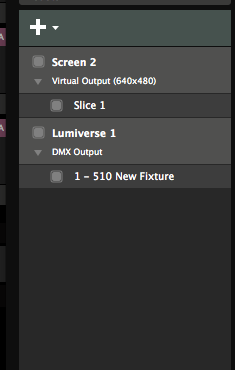

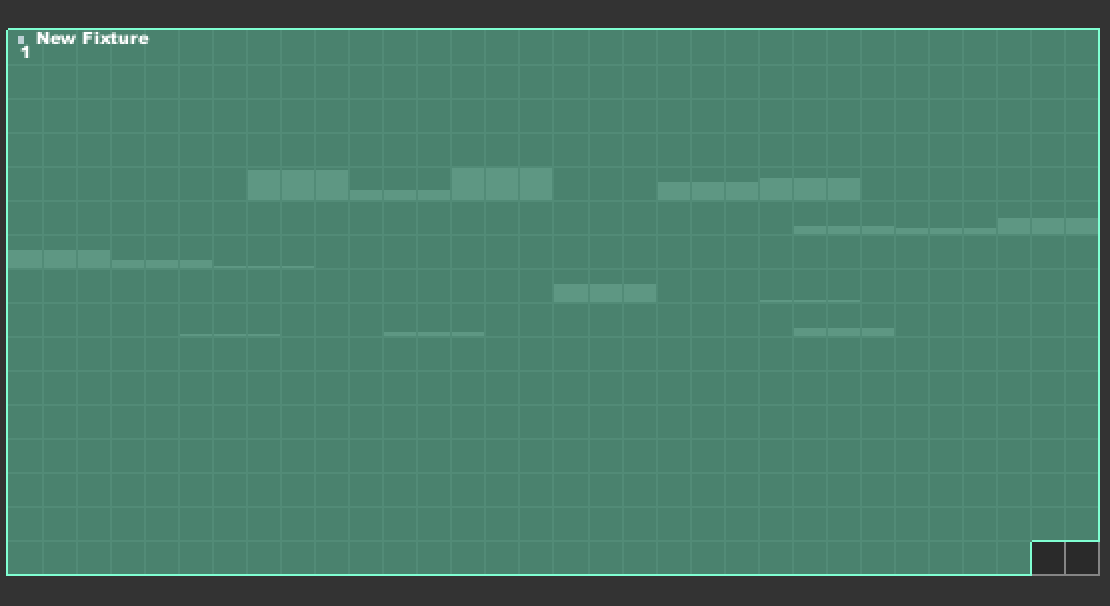

I have managed to get full strip minus one or two pixels (Only lets me go to 510) I have attached screenshots so you can see my fixture. Is it possible to change the pixel size in Arena? Also I now have 3 strips going but they are all mirroring each other and when I create an new lumiverse nothing happens and I can't control the 2nd or 3rd strip. Puzzled by this and there isn't that much info on this sadly.

Posts: 7678
Re: 48 Universe led pixel mapping help?
you have to assign each Lumiverse to artnet universes in Preferences - DMX.
do you drive rgb, pixels?
then each pixel will need 3 channels of dmx, that's why you get 170 pixels out of 510 channels, and no more.
