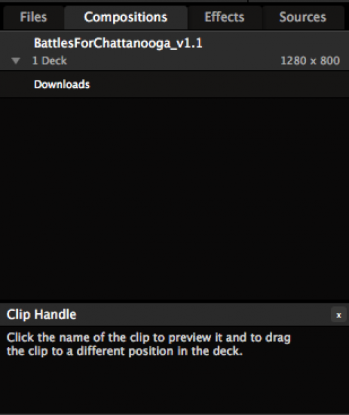

Is is possible to reload or restart an entire composition from the beginning? Whats the best way?
Currently, I am choosing the composition from the right hand column and it auto loads and begins to play.
Ideally i need to reload the comp on a single click that i can map either to a key or midi. That area doesn's show mappable.
HELP!!!
Im using Resolume on a permanent installation and need easy reload. It's not being babysat.

Is your whole composition in one deck?

Thank you for asking me that.
Yes, one Deck, one column about 17 Layers.
The question itself helped me find the answer. I haven't been using Resolume long but setting the DECK to a button seems to work!

you can map a key to the column trigger, if it's just one column to restart all the clips
Re: Loading Entire Composition from key
I'm not sure how your comp is run but assuming all your clips have the same duration another approach is to have all the clips in your last column set to autopilot and trigger the first clips in each layer. If some layers don't have clips in first/last columns, you can use solid color source clips set to alpha zero with an autopilot as well and adjust the duration of these transparent clips to match other clips in your first/last column.
You should also test Ravensc's controller which would let you automate the whole thing very easily.
