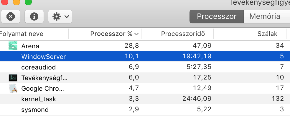

DayVeeJay wrote:Activity monitor does not show resolumes process.
look for Arena in the process list, it should be there.
or you could open terminal and use
top -l 1|grep "Arena"|awk '{print "PID="$1 $2 " Memory="$8}'
to print out Arena memory usage
