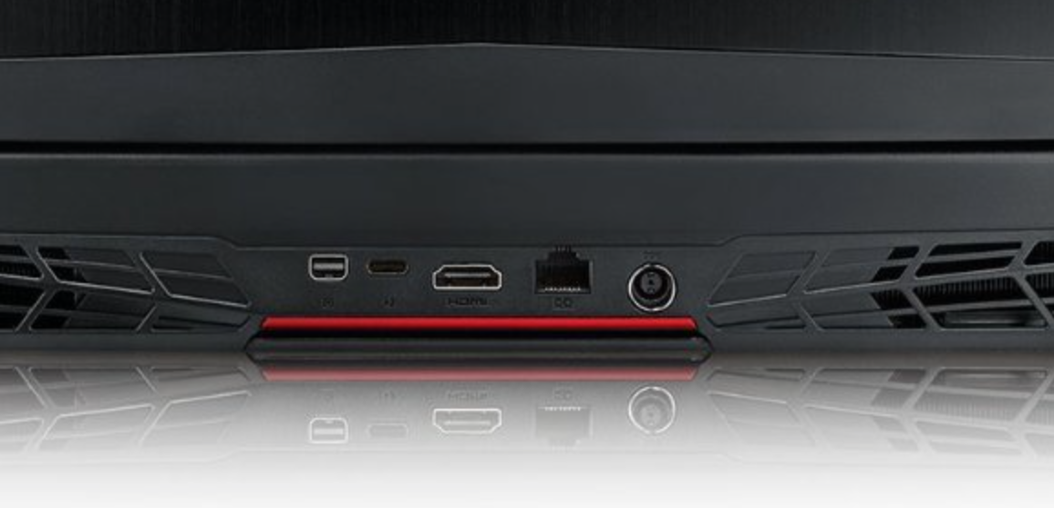

You can see that my computer has a USB-C port, as well as mini display and HDMI. I am trying to use a Black Magic Mini Recorder Capture Card. Im taking an HDSDI, and the capture card requires a thunderbolt cable to be connected to the computer.

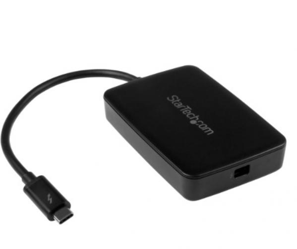

My question is, is it possible to receive a thunderbolt connection on my computer? I realize the mini-display port will not work for Thunderbolt, even though they are the same connection. Would this adapter below work?
Thunderbolt to USB-C Adapter: https://www.amazon.com/StarTech-com-Thu ... usb+type+c
Re: Thunderbolt/USB-C Question
Thunderbolt 3 is backward compatible with TB and TB2 so yes the adapter you're considering should work as well as the capture card.
