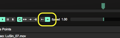

For now, when you make sure the clip is set to Continue mode in Timeline, it will pick up where it left off when you switch from SMPTE to Timeline.

Joris,
thank you for the suggestion about continue mode... that will do the trick :-)
