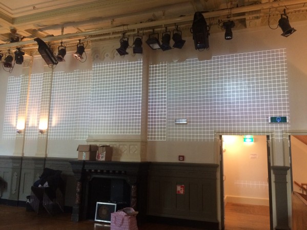

I have a gig coming up in a couple of weeks where I'll be using 3 projectors to project one large image on a wall, with sections mapped to certain parts of the wall. I am using the latest MBP with AMD Radeon R9 and 1TB ssd.

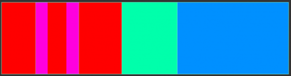

Below are screenshots of the venue and the output map I made for the mapping. The comp size is: 3072 x 768px.
I created slices for each section, and linked each slice to a layer. I also have a slice for the full composition. So that's 5 layers in total.

This is going to sound like grandpa getting on his high horse again, but to me, this is a good example of how layer to slice routing is often the wrong tool for the job. It's certainly not the first tool you want to reach for, because you run into dead ends like you're running into.
Personally, I would do all positioning and cropping in the composition. You would have four layers (red, pink, lime and blue), that are each positioned roughly where you want to have them in the final output.
Red and Blue are simply positioned to the far left and right. You can just use the Position X value of the layer for this. Judging by my eyeballs, they would have a dimension of about 1364x768. You can use the Layer Width and Height for this, or use a Crop effect. I'd use a Crop, because it keeps the content's aspect ratio in tact.
Lime is cropped using a Crop effect on the layer to about 340x768 (eyeballing here), and kept in the center. Pink is positioned to the left, and uses two Crop effects on the layer to keep the two columns.
Then in the advanced output, you simply create slices that take their input from these positions, and warp them to match the surface you're projecting on. Take note that I mean taking input by positioning the input of the slice over the same area, *not* setting the Input Source that layer. The Input Source can always stay on Composition.
Think of your advanced output as just a tool to align your composition to the surface you're projecting on. All positioning and cropping happens on the layers themselves. The advanced output is just there to do the final alignment.
