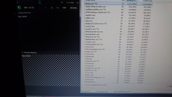

I have a weird problem with resolume that eventually causes it to crash.

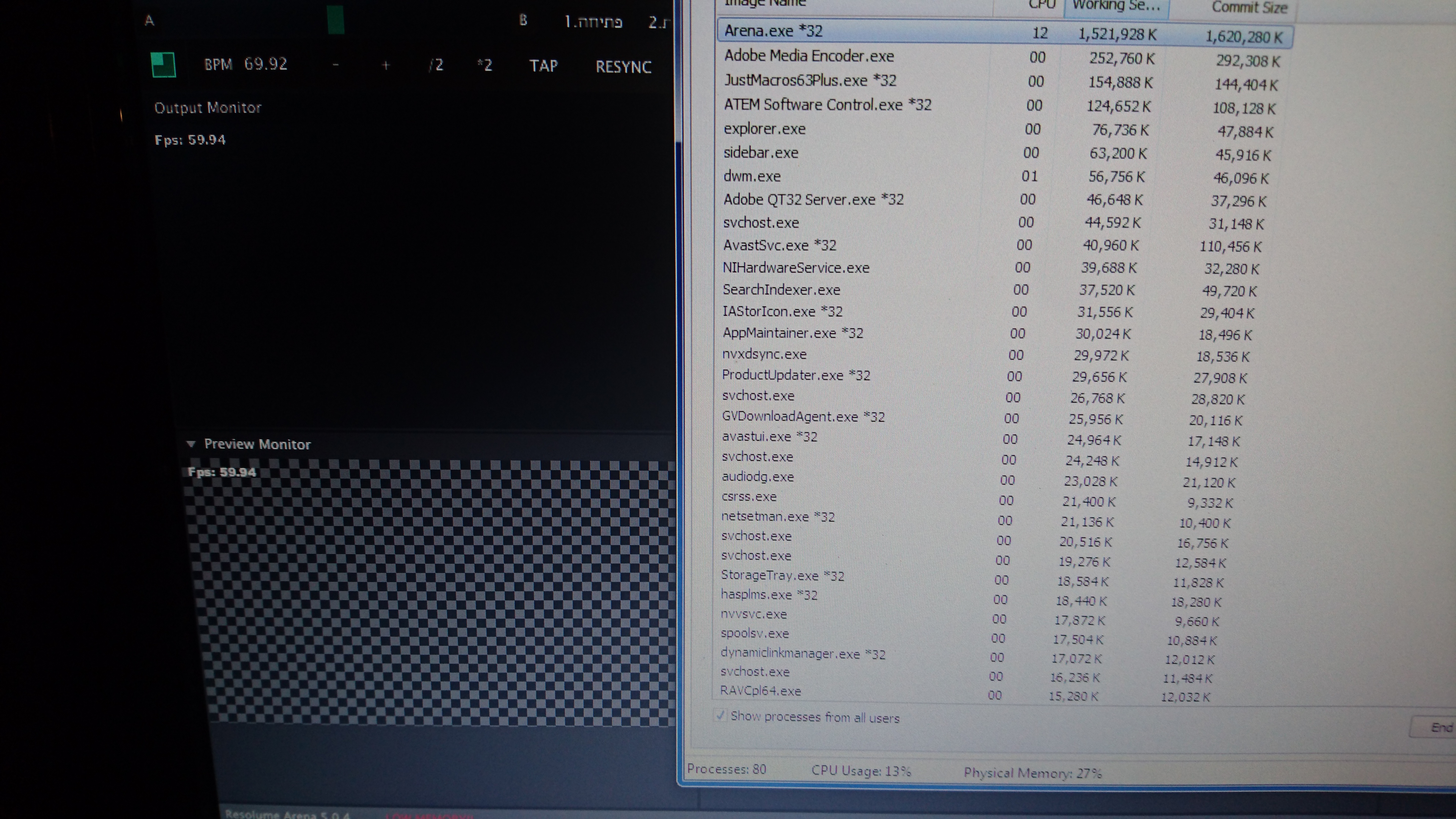

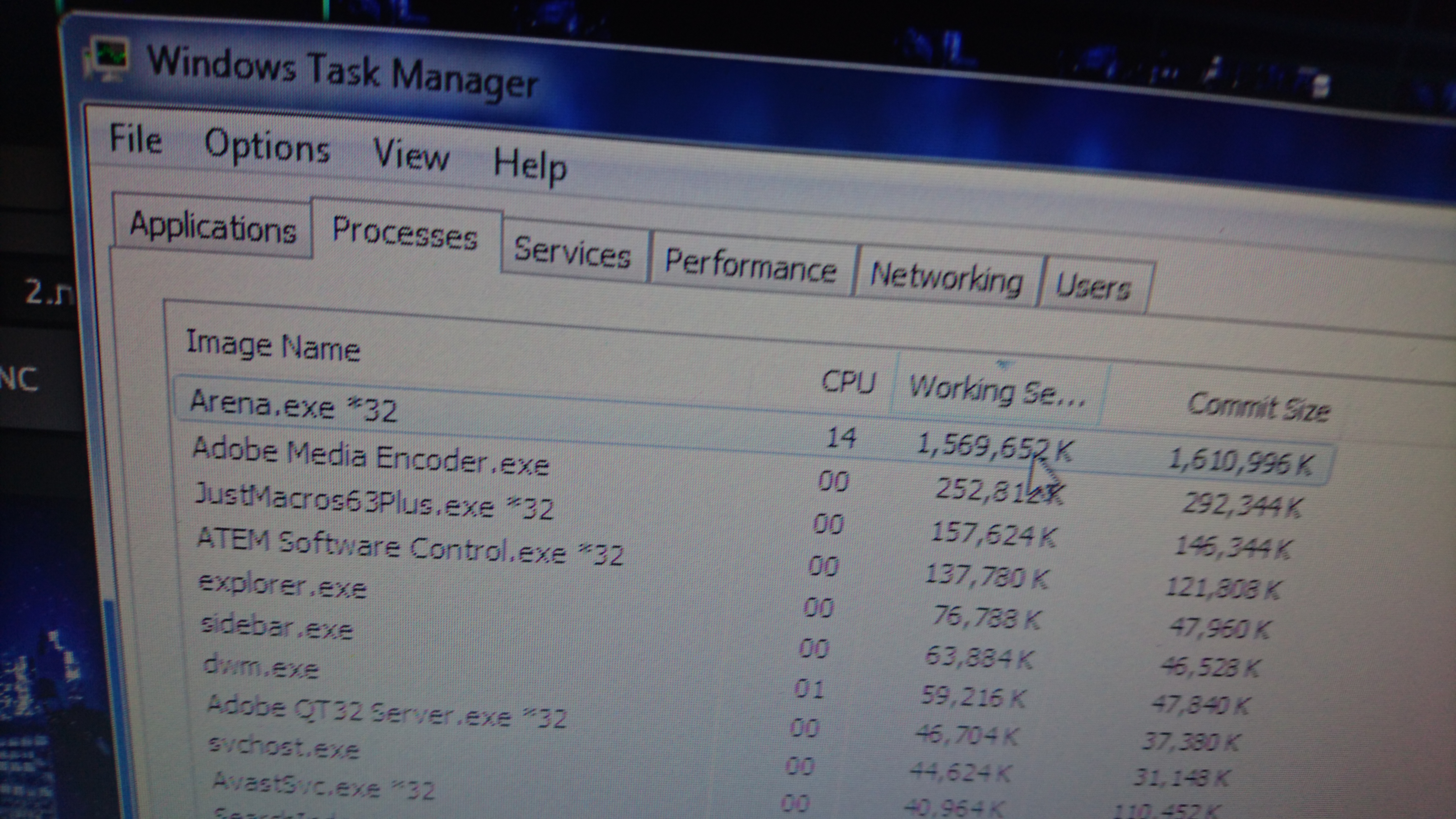

after a little investigation i found out that after i start the program the process memory keeps increasing without me doing anything, after going over 1500MB the "low memory" message appears and when going over 2500MB the program crashes.
I know that this is 32bit software and its limited on memory use but why it increases like that? its like buffering endlessly.
alll files on project are DXV3.
anyway of knowing what causes the problem?
i have attached here some photos and videos.
Thanks

Hmmm. That looks like a real memory leak.
Memory problems caused by unoptimised file formats would show a single increase of RAM with each file. This one seems to be steadily rising, seemingly without you doing anything else besides playing a single clip.
