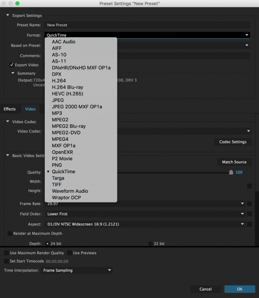

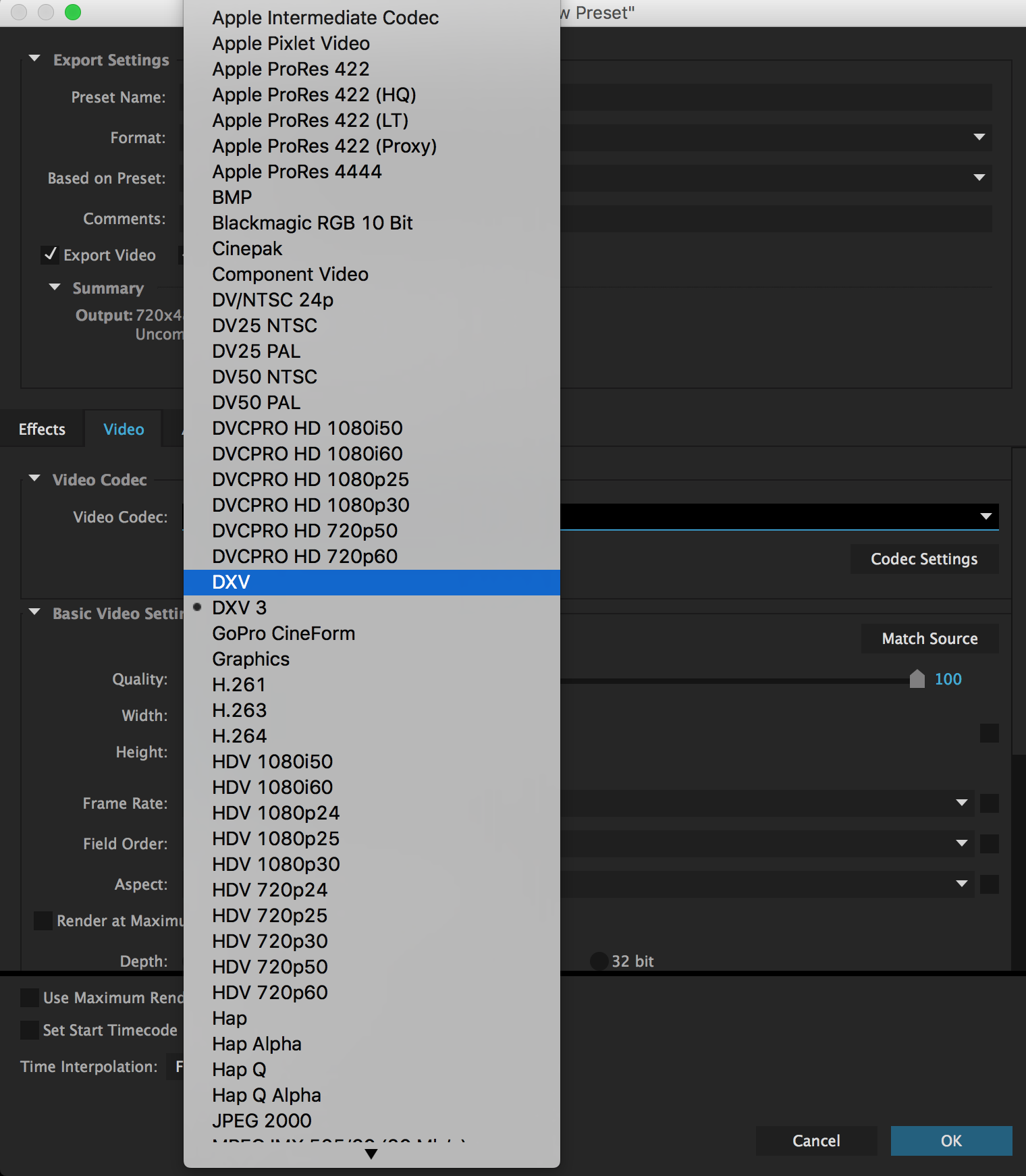

The DXV codec will be available under Video Codecs of the Quicktime format in AME. I'm attaching my presets in a zipped folder in case that can help you out.
- Attachments
- DXV3 AME presets.zip
- (38.5 KiB) Downloaded 1989 times

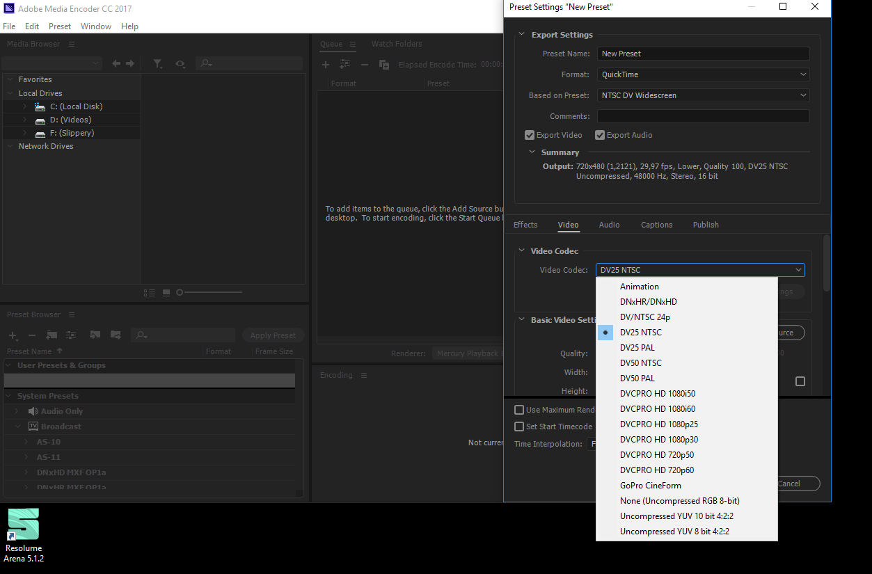

Thank you for the screen shot.
I do not have those codecs under Quicktime.
I am not using macOS, I am on Windows 10, x64, though the AME CC is x86.
This is what I have:

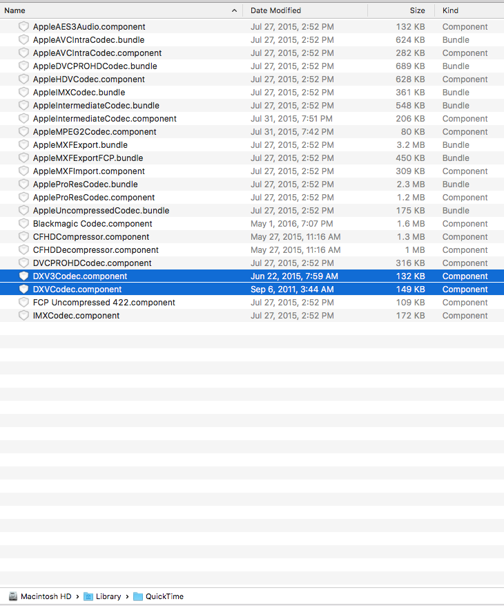

You might check your codec folder to see if they have been properly installed. Sometimes permissions won't allow the files to be copied, even when the installer says they have been.
In OSX the location is: /Library/Quicktime
For Windows I believe the location is: C:\Program Files\QuickTime\QTComponents = for 64 bit OS
Or: C:\Program Files (x86)\QuickTime\QTComponents = for 32 bit OS
*not verified, just from memory*
You should see the DXV bundles in those folders (picture attached, OSX version)
If the bundle isn't there, maybe open the DXV installer and find the bundle and do a manual copy/paste and see if that will work for you.
