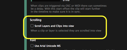

Hello there, newbie here. I'm so sorry if this could be an stupid question, but is there a way to set up resolume to stop jumping to a MIDI triggered clip?. I mean, when I push the controller's button I don't want it go directly to the clip when I'm in another place.

Back in the days of Resolume 4.1.9, a lot of people on the forum didn't like having to scroll back by hand to the clip that they triggered. They said Resolume should always scroll to the triggered clip or activated layer. It's one of the most +1'ed threads on this board.
We tend to listen what our users want, so that's what we added in the 4.1.9 release. Luckily, we also figured that not everybody might like this behaviour.
So we added a toggle.
In the General tab of the preferences, uncheck "Scroll Layers and Clips into view"

Joris wrote:Back in the days of Resolume 4.1.9, a lot of people on the forum didn't like having to scroll back by hand to the clip that they triggered. They said Resolume should always scroll to the triggered clip or activated layer. It's one of the most +1'ed threads on this board.
