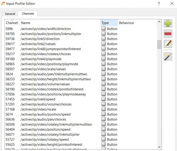

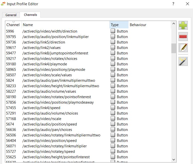

I experienced some issue while trying to connect Resolume and QLC+: Resolume outputs crazy amount of OSC signals at the same time!
In QLC I toggle the auto detection for signals, I press a button in Resolume and here is the result:
Almost 1000 detected channels while pressing only 1 button???
First: I don't really understand the numbers called "channel". In Arena I only see the address when mapping elements. But it seems in QLC it doesn't matters at all, it only cares about these channel numbers.

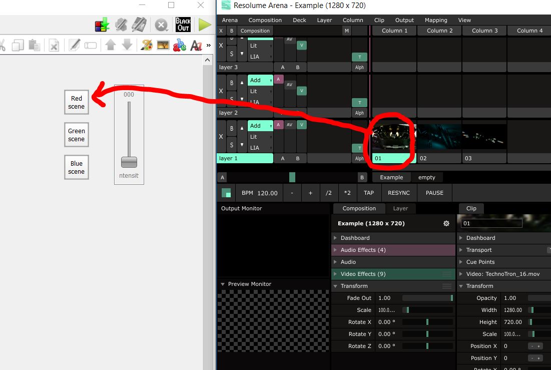

Second: While everything has its own unique OSC address in Resolume only clips dont. Why this is a problem? I would like to assign buttons in QLC to clips in Resolume. Lets see a screenshot why:
The plan is: When I trigger clip 01 it automatically triggers the red scene. Clip 02 the green...etc and maybe an effect slider could adjust the slider in QLC.
The good news is that this idea is already working (poorly) but because the multiple OSC outputs and because clips dont have invidual addresses its far from perfect right now :cry:
Thank you if you read this and BIG thanks if you can explain/help with this!
Posts: 7742
Re: Resolume OSC output
all clips have an individual trigger address:
/layerN/clipM/connect
where N is layer number, M is column number, and sending Integer 1 will launch the clip.
Also, to release the clips, you would use /LayerN/Clear 1 where N is layer number.
To access all the OSC addresses you need in "Edit Application OSC Map" make sure you're in Focus:Deck mode.
