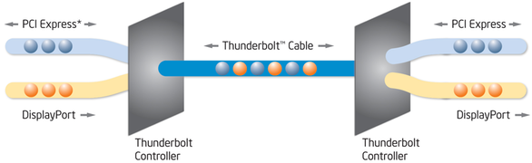

As a note, DisplayPort is an output not an input so your BMD Mini Recorder is actually using PCIe (input/ouptut) on your Thunderbolt port which is both DisplayPort and PCIe.

I have a PC that I built for shows. In my GTX980 I have 3 Displayports and an HDMI port. Based on what your saying I won't be able to take input through these ports, which I was starting to suspect before I read this. My computer does not have thunderbolt ports.
Correct!
Does this mean that my Displayports work as a PCI-E port?
No but some motherboards can take a Thunderbolt adapter and you would connect your GPU to the TB adapter to combine DisplayPort and PCIe on the Thunderbolt pipeline.
