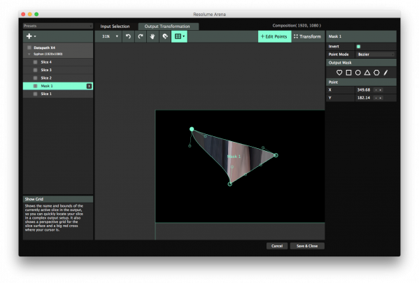

Only con to this, is in the output you do not have a reference to where you are creating your mask. Please add this ability.
Re: free hand drawing for mapping and masking
[quote="cvanhoose]Only con to this, is in the output you do not have a reference to where you are creating your mask. Please add this ability.[/quote]
With your mask selected, select [Show Slice Grid] and [Show in Output] and you will see your points and handles as well as as a red cross line for your cursor in your output.
