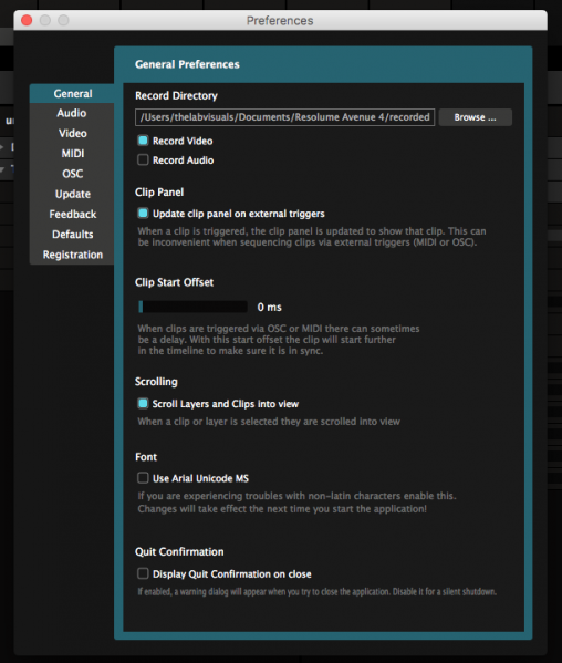

I don't think there is any problem with that at all. Depending on how you use your controller (MIDI or OSC). I've uploaded a small video showing it work with an APC40 mkII.
I'd set a MIDI control // OSC value [Preview] clip at regular intervals. I've used 12 clips per "hotkey".
Then when you press the mapped button on your controller it will preview only the clip and the entire deck content will move forward or back. Do make sure though you have set Resolume preferences to "Update tip panel on external triggers" (See attached image) [Preferences] / [General].
One "obvious" obvious thing I'd look out for is available ram, and overall deck size. It's likely to take a while to load a massive deck of content and if one or two files moved folder than relocating them could be an issue.
