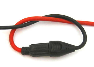

If you need to extend cables, a fast way to help them stay together is making a tie on them, if you don't have velcro or tape at hand.
Always have velcro or tape at hand :) as tying puts stress on the cable, and will wear out the cable at the connector.
