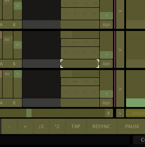

how do you usually control resolume?
in midi mapping for example you can map a specific knob to all the layer's playing clip position
different length clips probably wouldn't be in sync when turning the knob, but you could quickly navigate in your clips without having to map the cues individually.
