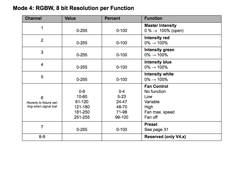

One thing I don't get is if I choose the RGBW mode for instance on Resolume that will give me 4 channels right? But in the skypanel the RGBW (8 bit) has 9 channels so how I do I match them?

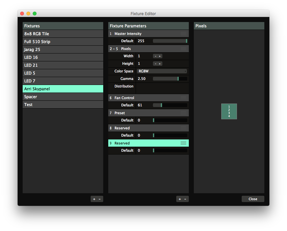

Cool thanks. But how come I couldn't get that to work when I used that fixture (RGBW) on the skypanel and also on Resolume. On Resolume I created a 1x1 RGBW Fixture Am I missing something?
In the fixture settings on Resolume do I need to add 'parameters' below my RGBW fixture in order to have 9 channels and therefore match with the amount of channels skypanel has?
Many thanks
Many thanks
Re: Arri Skypanel Fixture settings?
Close. You need to add the Master Intensity above the RGBW block, the rest below.
Note the default values for Channel 1 and 6 are not 0.
