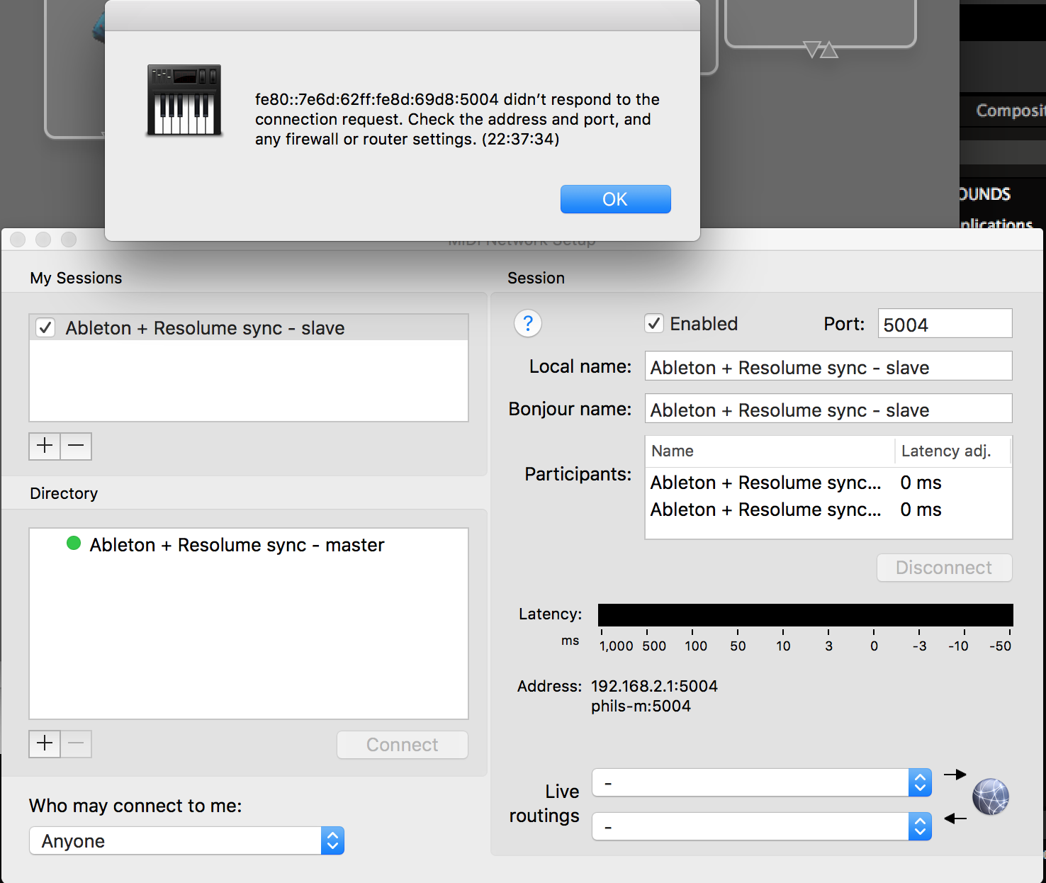

I have a gig coming up next week where I need to sync Ableton and Resolume. For some reason I can’t get a stable network between my two MacBook Pros even though I’m using the same method as I did successfully 10 months ago.
I am using Audio MIDI Setup to connect the two machines together using the 'Network' function. One is my 2016 MacBook Pro running Sierra (for Resolume) and the other is a mid 2010 MacBook Pro running El Capitan (for Ableton). I have connected them via an Ethernet cable to Thunderbolt adapter. This setup all worked fine before but the newer machine was then on El Capitan.

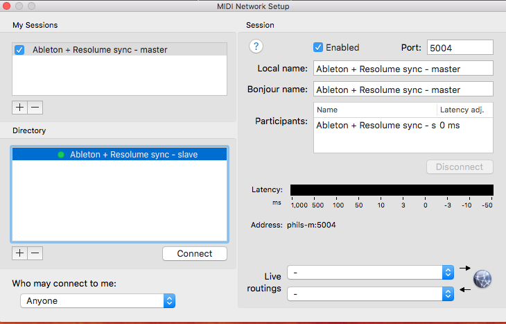

I appear to have set up the Network session correctly - using port 5004 and creating master and slave machines. Each finds the other in the Network directory but I get an error mesage on the newer MBP which is in the grab below. Actually sometimes I get error messages on both machines relating to failed connections, sometimes just one.
I need to get this working urgently. It would be great if anyone has any advice on how I might move this on.
Thank you : )

that error message looks like it would show an IPv6 address that it is trying to connect to.
Do you run an IPv6 local network?

ravensc wrote:that error message looks like it would show an IPv6 address that it is trying to connect to.
Thank you. I don't know what an IPv6 network is. I have my Macs connected on an Ethernet network via a router most of the time but when I'm connecting these two together for this purpose it is with a single Ethernet cable (with a Thunderbolt adapter at one end). No other network cable is connected. I haven't double checked to see if wifi was left on on either machine and it might have been trying to connect to something. How would I investigate whether I have an IPv6 network set up?
Thanks
ps - just had a look on the two laptops in System Pref/Network/Ethernet/Advanced/TCP/IP and nothing is configured under 'Configure IPv6'.

Looking at your pics, it looks like your slave doesn't have an IP address. It should read 192.168.2.X:5004 (since your master is set to 192.168.2.1:5004) so make sure you have your IPv4 configured properly in your slave network settings so follow Ravensc's directions.
