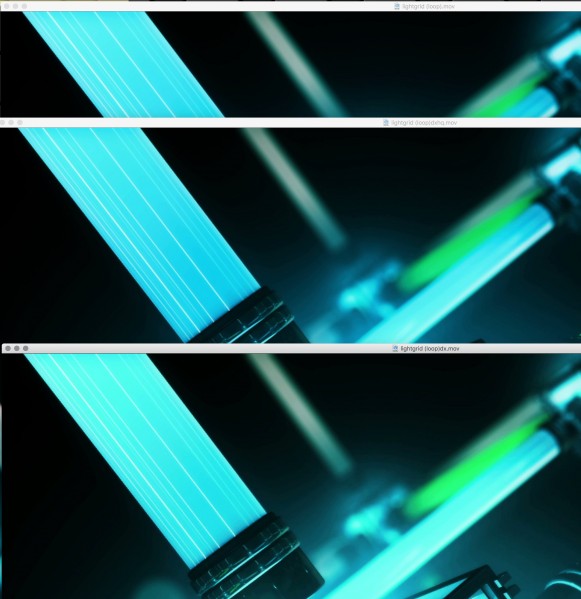

Hi all, I see that when I convert my Photo JPEG files to DXV3 (normal quality, no alpha), the colors are not matching. There are small differences in some parts, and a general glow effect seems to be present everywhere. Is it normal? Using high quality seems to fix it somehow (but it's still a bit different from the original), but it produces a huge file. Given that DXV is proprietary, codec support is minimal and it loses video quality I think I'll stick to Photo JPEG for my background videos. Even at the cost of something like 15% of performance decrease.

DXV codec is losing color information

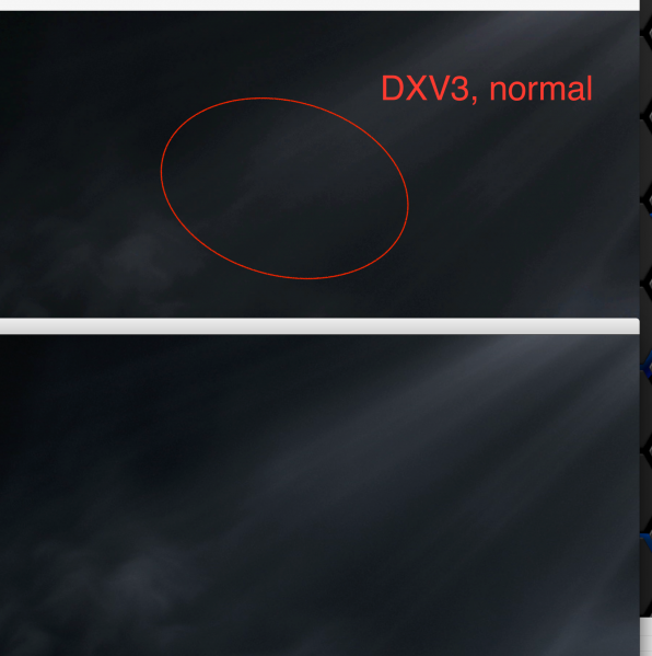

Also there are BIG issues with smoke, probably due to a lower threshold with similar colors, I'll share a screenshot. I'll also post the other when I find it.

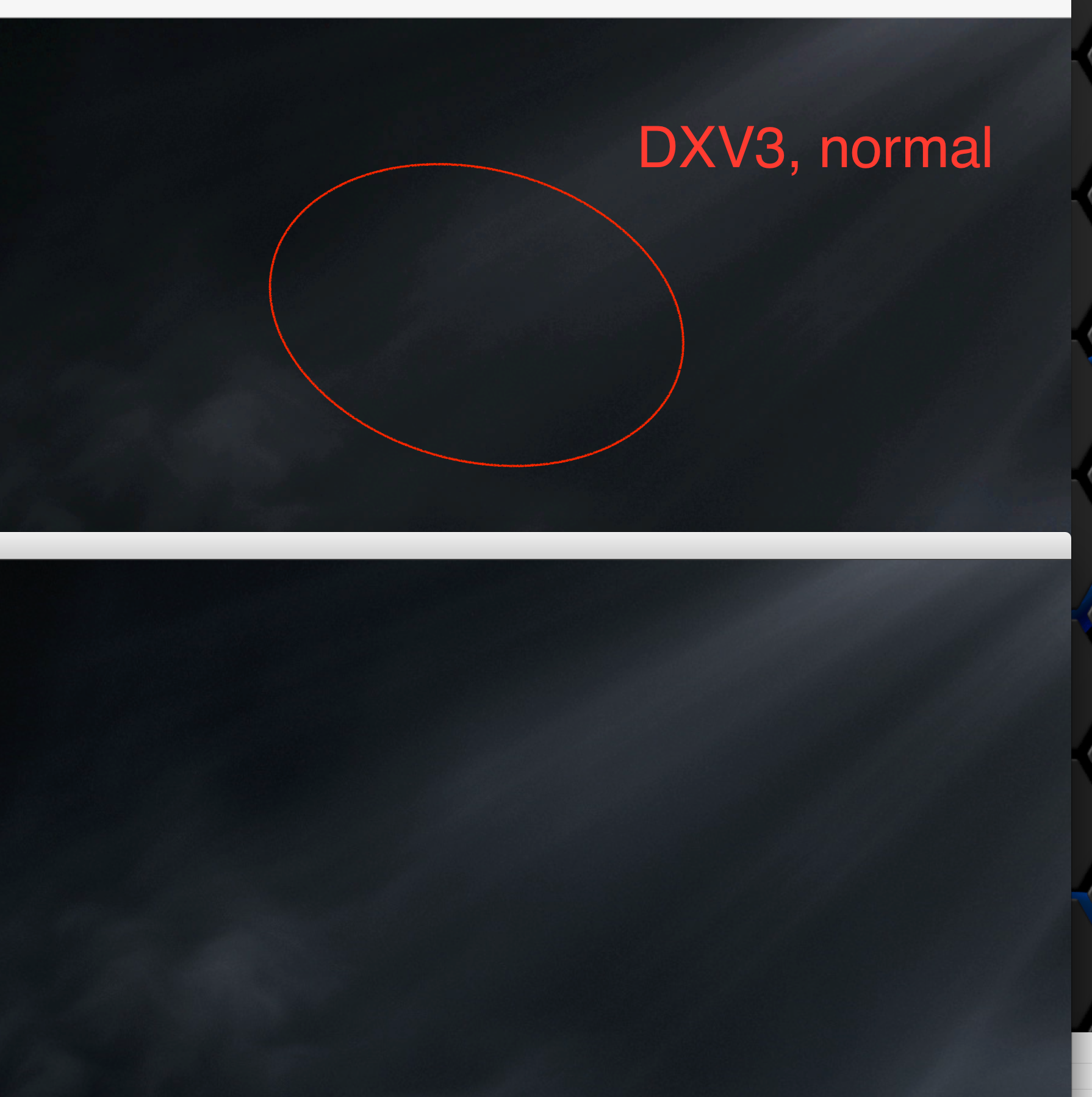

Here's another where it's losing color accuracy, the faint glow effect is probably due to this.
No problem anyway, I'll just stick to the HQ (2.5x the size). Even if it makes MPEG Streamclip crash, damn.
