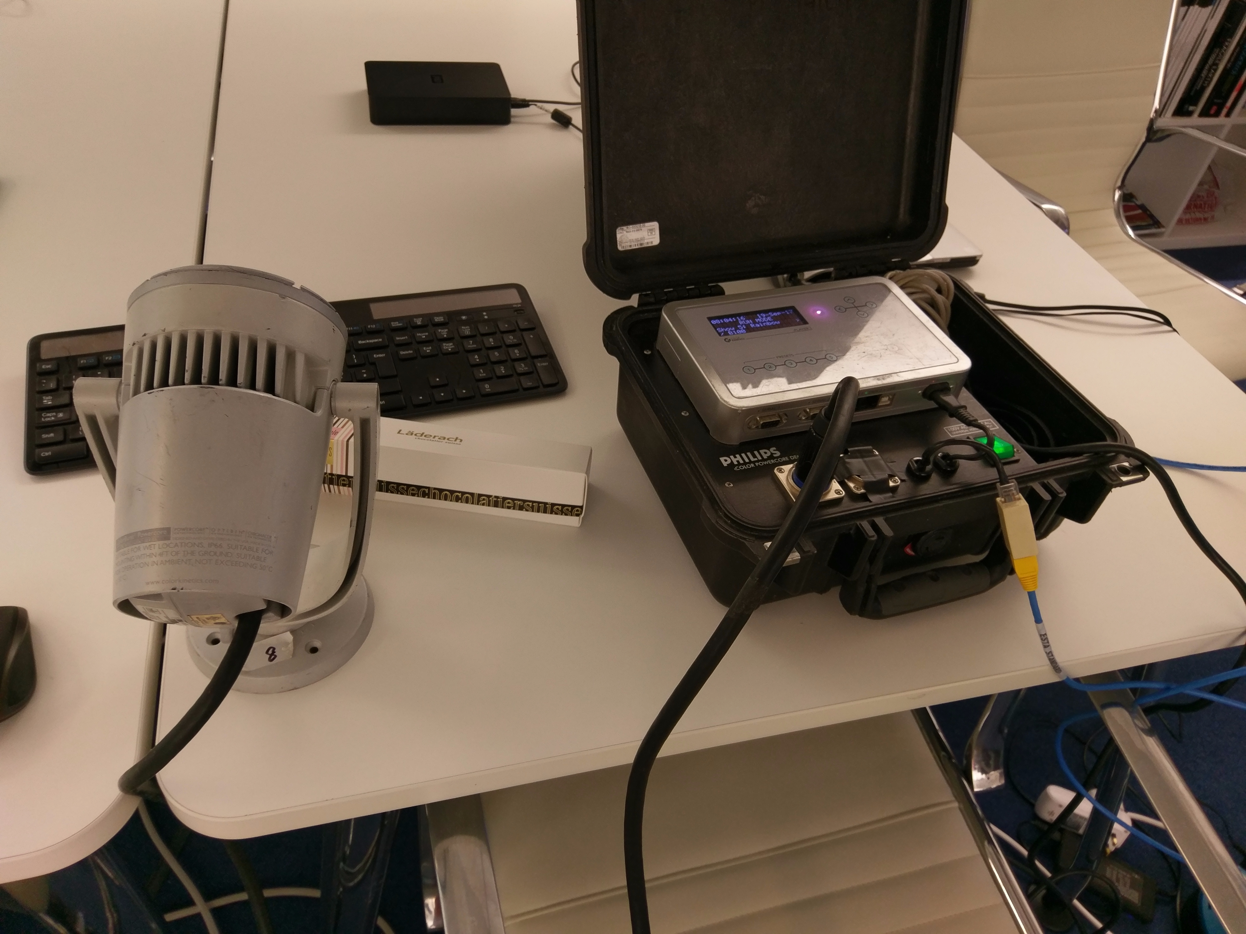

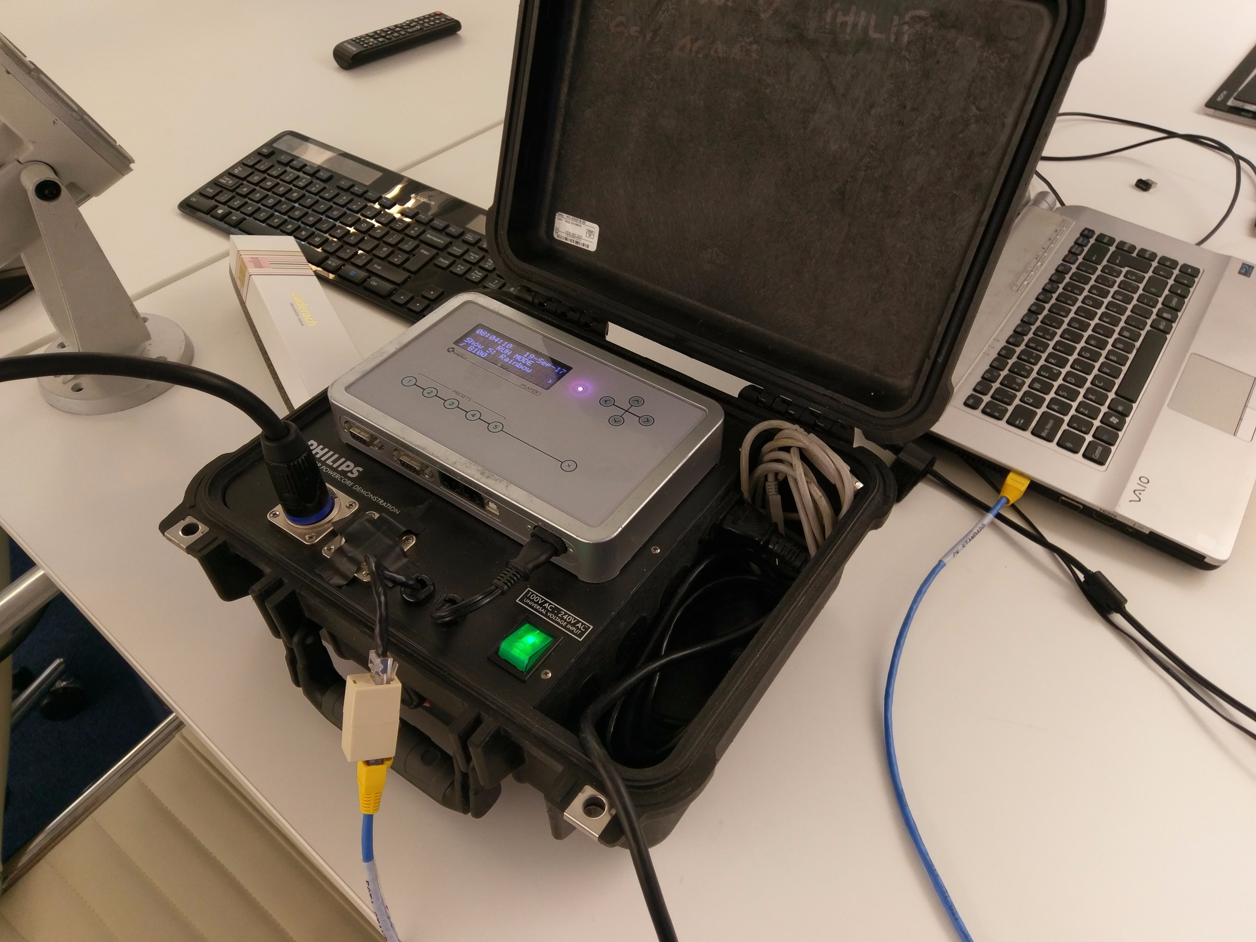

I am aiming to control some color Bursts and Color Blasts from Philips through Resolume 5. I have an ethernet cable that is wired up for DMX and it is connected to the Icolor control box (see pic) bypassing the iplayer ( Not using the iplayer from phillips) but I cannot seem to have any response at all from the fixture. I did create a fixture and lumiverse with 3 RGB channel fixture with no luck.
When I check my preferences/DMX I can see Resolume sending ArtNet signal to broadcast.
Am I missing something?
As Resolume is sending ArtNet protocol, do I need any sort of ArtNet to DMX conversor between laptop and box?
I am completely lost as it is the first time I am trying to control DMX RGB fixtures through Resolume despite I am familiar with DMX etc from my lampy background.
Many thanks in advance!!!!!!

Ethernet cable wired to DMX coming from an Ethernet port, won't work.
They are different standards. Philips is very misleading in this way.
The RJ45 you see on the iPlayer, in fact uses only 3 wires like the 3 pin XLR does, it's not ethernet.
So you'll need to use a usb DMX controller with resolume, or an Artnet to DMX converter.
You need to connect the DMX output to the fixtures directly.
