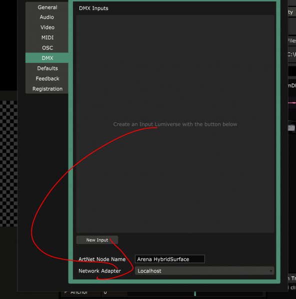

In the meantime, at this point, all you need is to do is have be connected to a network adapter (WIFI or wired) and use your own IP address to create a localhost relationship. I can make that work on my MacBook Pro in and out no problems.

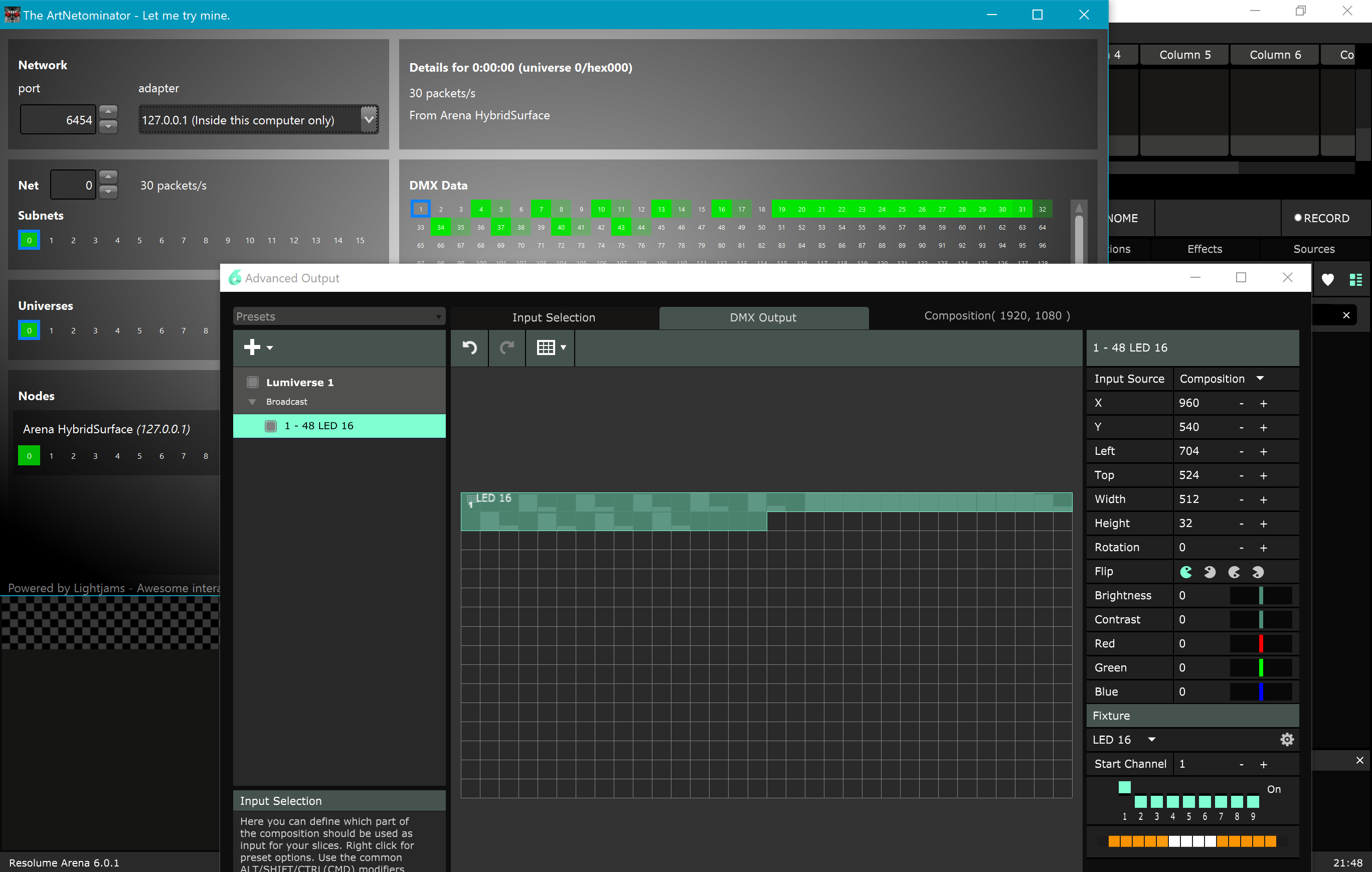

I just tried outputting to Artnetominator via localhost on 6.0.1, and it's working just fine.
There's a lot more to Art-Net than just setting up a IP and port, and if one application does things just a little different from what the other application expects, chances are it's not going to work.
As far as we're concerned, Art-Net data is leaving on the selected interface. That another application is not picking it up is out of our hands.

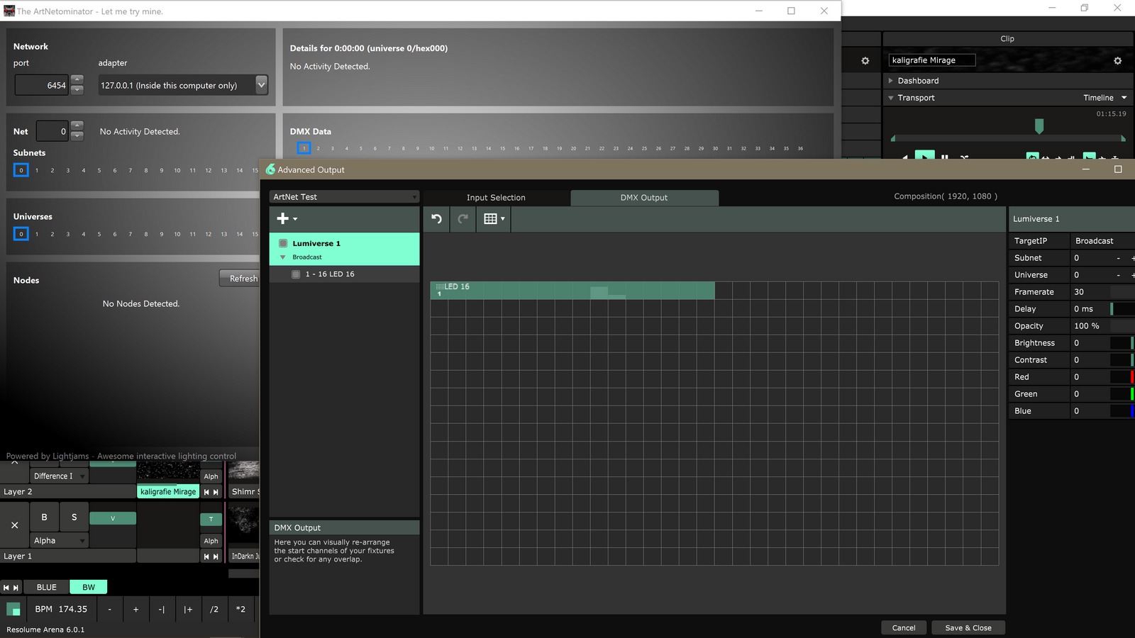

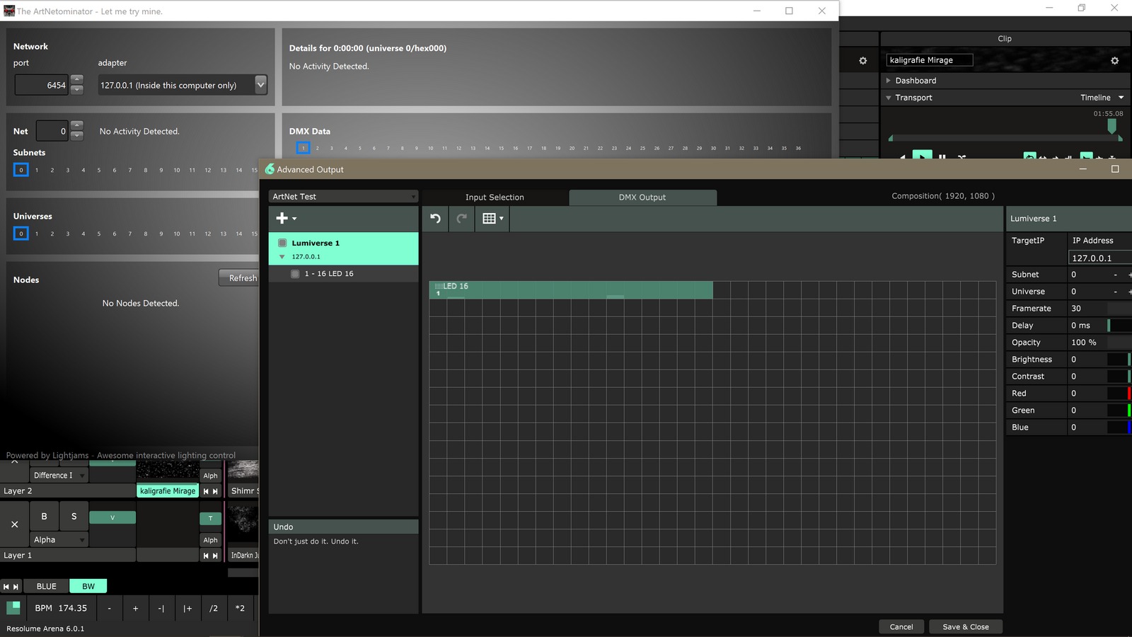

thanks for the screenshot - this is not working for me.
But in any case you used broadcasting. This won't work in any bigger network environment, you will simply spam every ArtNet node around. Hence the request of this thread, send ArtNet to Localhost/IP 127.0.0.1 explicitly. (Or use localhost-broadcasting to 127.255.255.255, which works in R5.1.4.)
@Oaktown That does work of course, but defies the point of this thread. If I use my network-adapters IP for "local hosting" then this ArtNet data is send out into the world. But instead I want to loop it back locally, refine it in another software, and then output it through my network-adapter.
I know. This is broadcasting on the localhost adapter, which will all resolve to 127.0.0.1

Ah, right! I was under the assumption that in R6 everything under prefs refers to DMX input, while DMX output happens in the Advanced Output settings entirely.
Well, I guess I should've better RTFM.

Btw. to beam R6's Artnet DMX output to QLC+, it still requires IP 127.255.255.255 instead of Broadcasting. God knows why. Won't show in Artnetominator then...
