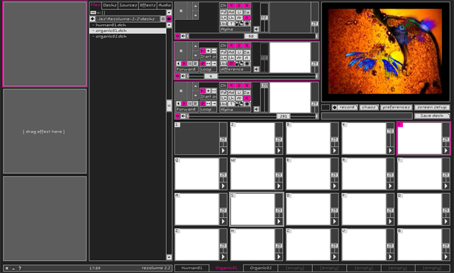

I had a go on Resolume with a Vj friend and I was so impressed with it that I decided to buy it straight away!
I just installed it on my machine and I had a nasty surprise... I can't see my decks! I can see the files when I load them (with the eye icon) and I can save decks, I can even play... but I can't see the previews! I enclosed a screen capture of what I see... I foresee a lot of difficulties doing a gig with blind previews...
Can you tell me what's could be wrong?

Files: Flash and AVI,all encoded with Indeo XP 5.2

If anybody out there is having the same problem, the good news is that there is a way around it: double loading the clips. The first loading will show a blank deck but if you re-load each clips on its spot on the deck (even not seeing the clip youâre calling they can be identified on the preview window), the deck become - and remains - visible. This procedure is necessary only for the first deck, all decks created after that will behave normally. Unfortunately this is not true of the decks created beforeâ¦
The bad news is that it doesnât make much sense. I sent a step by step description of what Iâve done to Bart&Edwin, I hope that they come up with a logical explanation or fix this bug, if thatâs a bug.

I ran across this issue myself - and then found your message...
I am still trying the software but I found out what your problem is.
You saved your decks by right clicking the name tab at the bottom of the interface.
If you click the button labeld "Save Deck" instead - all will be there on reload.

Are they Quicktimes ?
Code: Select all
Quicktime (.mov) movies do not play and give a [color=Red]white [/color]preview.
Some quicktime movies do not work because they are streaming quicktimes. They are made to be viewed embedded in a website and not for vj-ing.

another solution that i came up with was NOT to preview the clips when saving deck, regardless if you use the "save" at tab or button. meaning, load footage into channels and set properties/effects by right clicking, but do NOT click on channel so that it runs in preview.
this seems to be a preview problem when saving decks.
also, if you open those .dck files in notepad with decks that do not have this problem, you will notice a big difference in the binary pattern. for example, the one that had problems had a large section of "Y's" after the word "preview".
hopefully this helps Bart & Edwin.
btw, i was not having this problem and i'm still using 2.0, but just today i started having this problem and i did note that my old avis and new ones had different header info when looking at them in abcAVI tag editor. so that may a bit of an issue too.

i uninstalled and reinstalled resolume and that did not work, HOWEVER...
here's another solution around this issue:
load a deck that loads fine (hopefully you have one of these). then start replacing each channel with new footage and "save as" (tab) to a new name - do NOT replace this deck that loads fine, save it (even make a backup), you're gonna need it as a template to create new ones. after the initial "save as" (tab), then i have been using the "save" button for continuing to save.
so far this is working...
but i really consider this a major issue and one that is hard to determind a pattern - seems like something is ultimately set in registry and a fresh install of o.s. is needed, but i do not have time for that now since gig is tonight.
