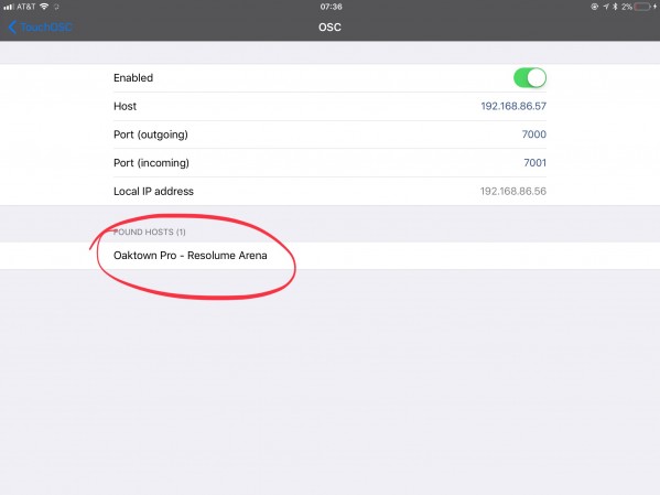

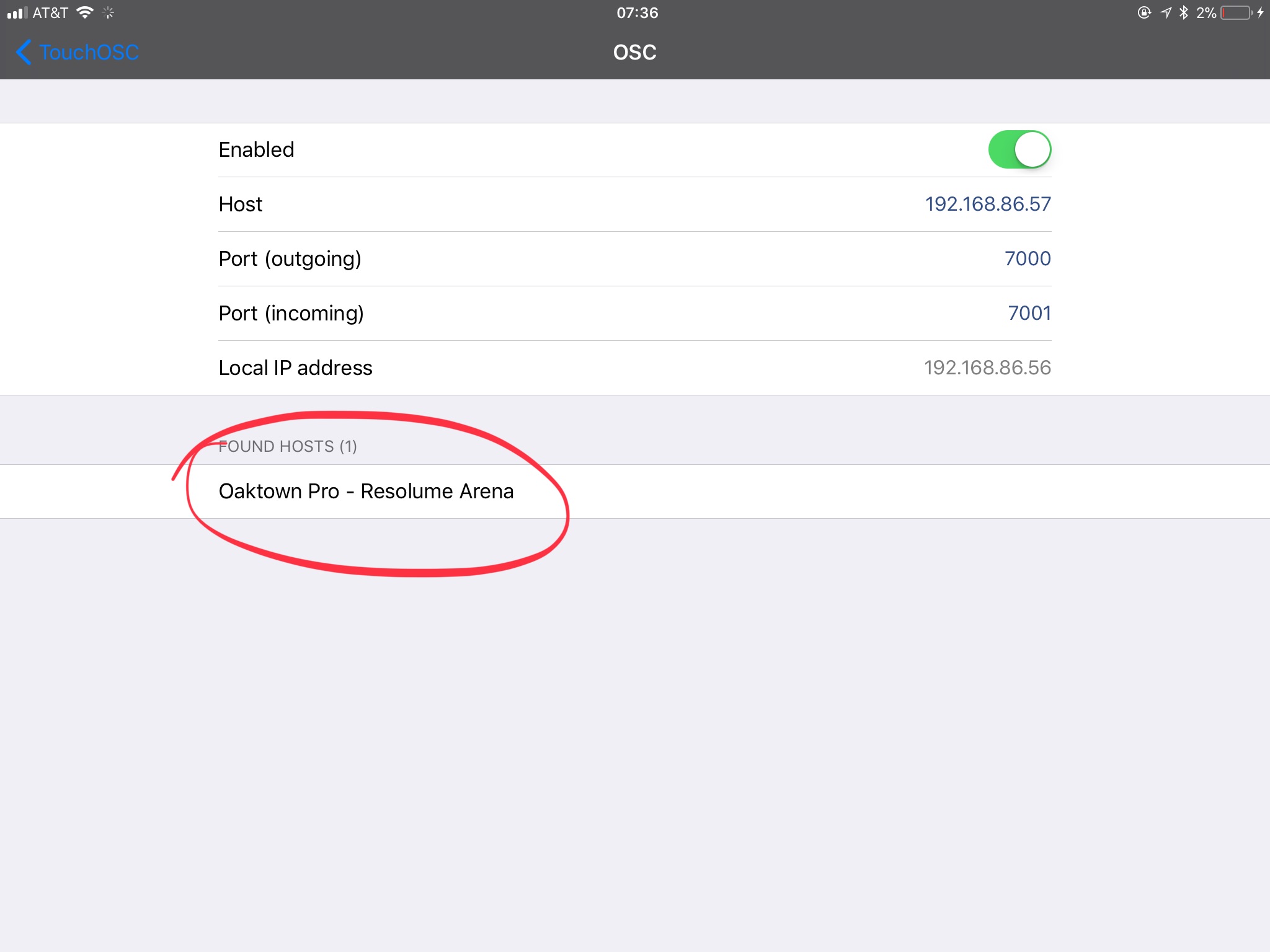

Have you tried changing the ports in TouchOSC to match the default ports in Arena (7000/7001)?
Also I can't tell in your screenshot but are you seeing Arena as a host in TouchOSC. See picture below of what you should see:

Oaktown wrote:Also I can't tell in your screenshot but are you seeing Arena as a host in TouchOSC.
I don't think that resolume 5 will show up in touchOSC, R5 doesn't support OSC zeroconf (I think that screenshot is from R5)
R6 does and shows up for me in touchOSC.
Yes I just realized that his screenshot of Arena preferences is from R5!
