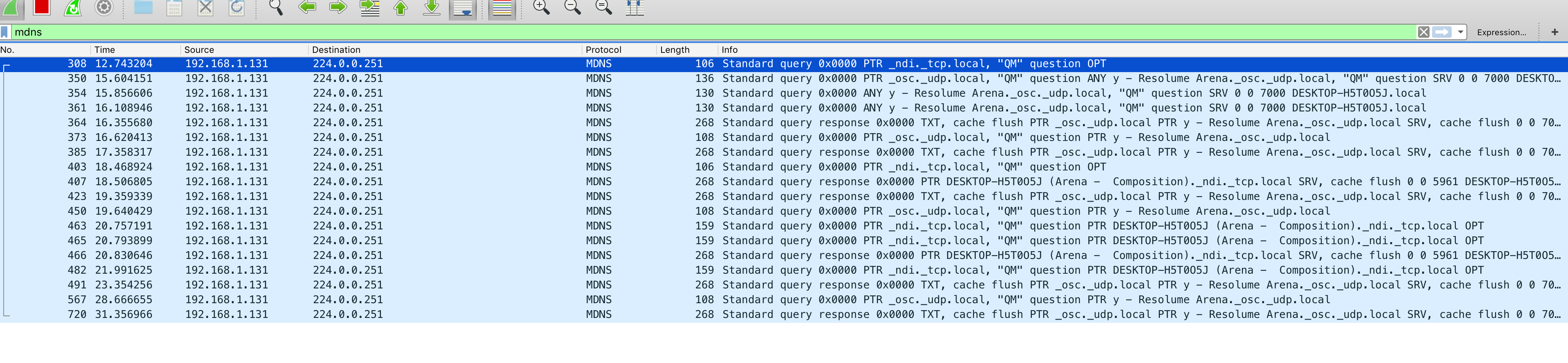

In the 'Apply a display filter' textbox enter mdns and press enter.
Now when you start Resolume 6 on the other machine and enable NDI output you should see mdns packets come in, they will be placed on the bottom of the list.
They should look somewhat like this:
there are some OSC related lines here, I have OSC enabled in resolume.
You can also see lines containing "(Arena - Composition)._ndi._tcp.local" those are about the composition NDI output.
Once those are in, and you try to connect to the NDI output of resolume, and the connection is established, there should be a lot of TCP packets going back and forth. You can just clear the filter to see those.

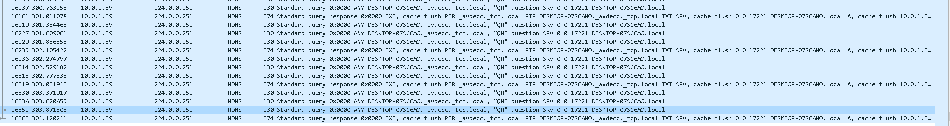

Firewalls on both machines turned off, R6 running on both, Wireshark running on both. All network adapters but the wired connection set to "disabled". Seems to be trying port 5353, but nothing related to Arena or NDI, just AV decoder
I sent in my log file, I did not see any lines referencing NDI
One thing I notice when running NDI camera, the packets from the camera are TCP based, but the packets coming from the 860m machine are UDP based
