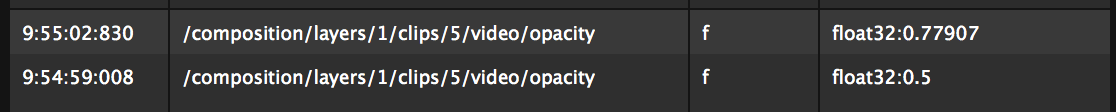

Same here, it works fine.
This is what I get in the OSC inspector as input:
