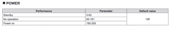

So, by using timed [Solid Color] clips, you should should be able to turns your projector on & off by sending Art-Net values to your projector on Channel 8. Just make sure your Net/Subnet/Universe are set right.Also, if you have the right HDBaseT transmitter (Panasonic or third-party), you should be able to send Ethernet, Video & Audio (as well as RS232 and IR) on a CAT6 Ethernet cable.

I am near... the projector get the artnet infos, I can see it in the artnet status, I made a solid color at 50 and another one at 250... but the projector don't turn off ...

I would use a black clip and a white clip with a single luminance channel fixture to get 0 or 255.

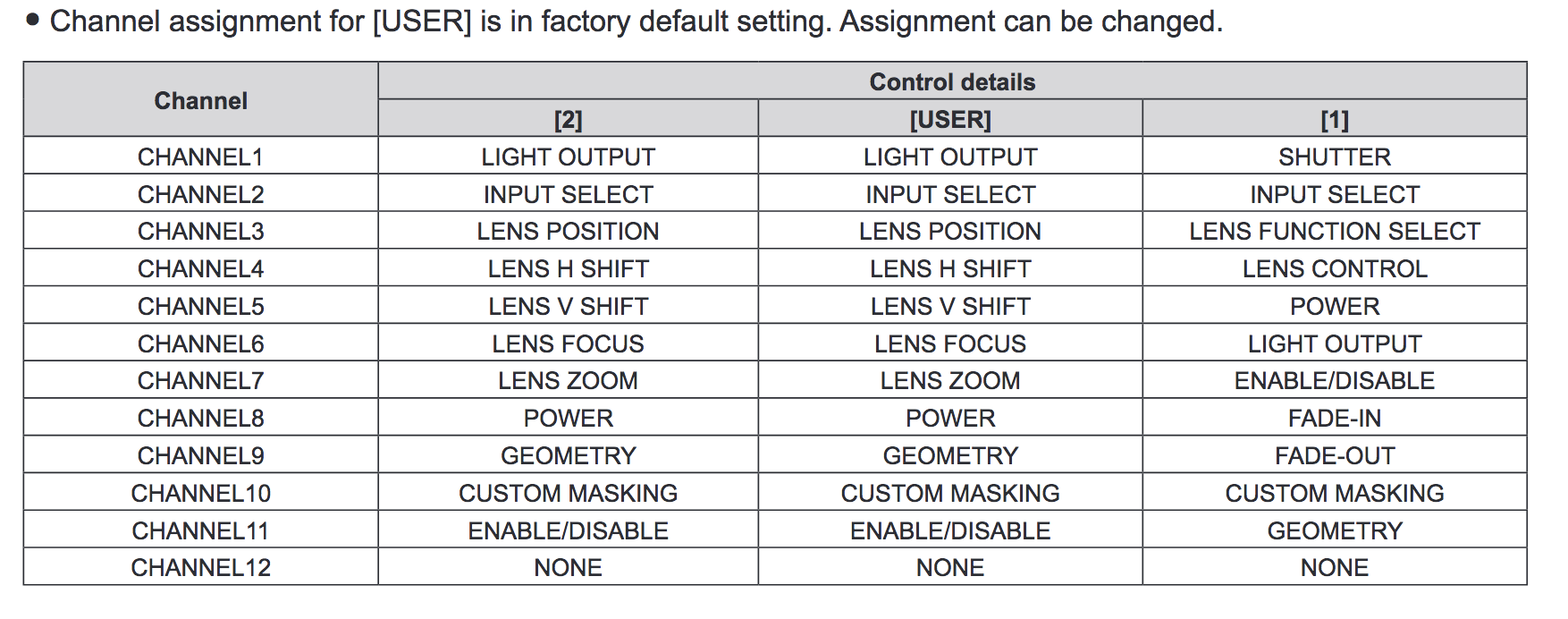

If you use channel 8, make sure your channel assignment is set to [User] or [2]. Otherwise if you're in [1].use channel 5 for power.

Hey, working good now,
that was the channel 11 that need also to be controlled in order to enable the artnet commands.
